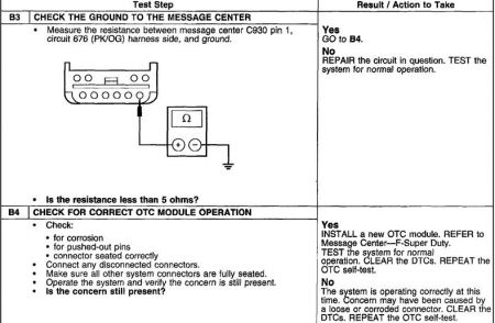

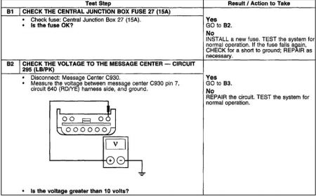

Recently after fueling up I noticed my information center was no longer working. It is located between the sunvisors at the roof of the cab. I am thinking it is just a fuse somewhere but I wanted to know where would the fuse for this be located.

https://images.2carpros.com/forum/automotive_pictures/266999_250_4.jpg
https://images.2carpros.com/forum/automotive_pictures/266999_2501_2.jpg
