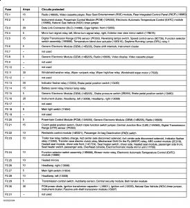

Number 45 fuse keeps blowing. It is 10 amps. All the gauges stop working and the battery does not charge. Now the fuse stops blowing and no charge or gauges. TY

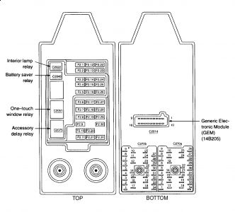

https://images.2carpros.com/forum/automotive_pictures/62217_150fuses_2.jpg
https://images.2carpros.com/forum/automotive_pictures/62217_150fusesb_1.jpg
There are several fuses for the IP, did you check all? Central box has three! 2, 16, and 30....
