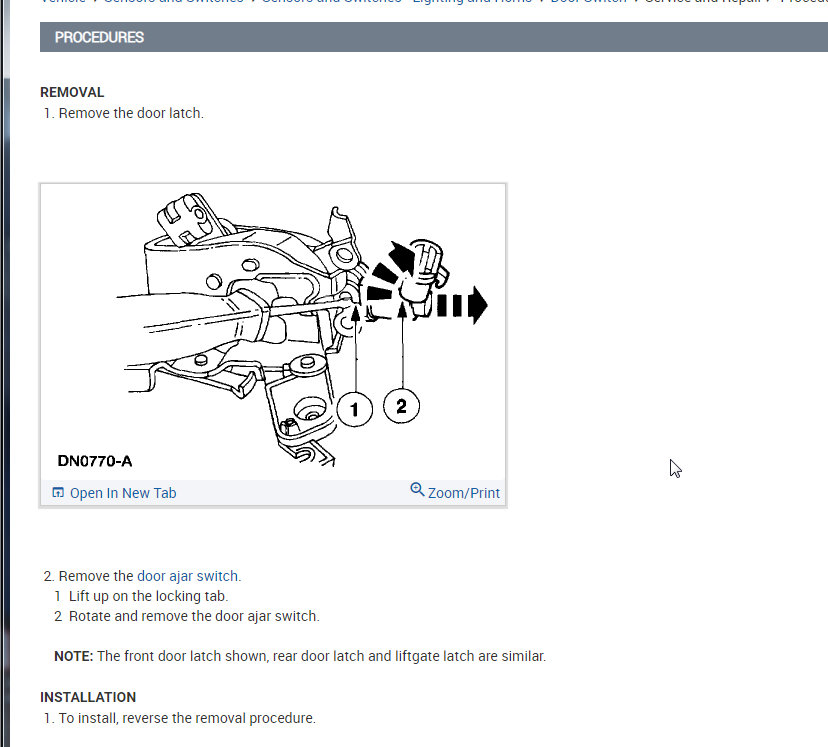

TLJ
when doors are closed ajar light is on open both front doors light goes out. dome light is same as ajar light,dome light stays on 1/2 hour doors closed less than a minant open , doors closed dome light will not shut off when key turned on
Jan 21, 2021 at 5:25 AM (Merged)
This is because you have a door ajar switch that has failed. We need to replace the switch that has failed however, if it is both front doors then you have two failed switches. It is unlikely that the VSM (security module) has failed as you would most likely have other issues then just the ajar light and dome lights.
However, the dome light is staying on because the module thinks the door is still open so that causes the light to stay on.
So take a look at the attachment below and let us know what happens. Thanks
