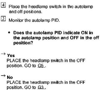

I believe we are talking about two different things here, hehe. The day time running light unit is probably faulty, which is causing the lights to stay on. Your switch that you are talking about is the one that enables the lights to stay on for a brief amount of time after leaving vehicle, correct? In any event, here are four tests to do to check for faulty unit. Post your results and I will have more tests to do if the problem is not fixed. Before doing these, check all of your fuses and relays, inside the cab and also under the hood. Make sure all of the wiring is good and not loose or melted looking. Make sure fuses are not blown and power is getting to them. Fuse 19 (5 amp) and DRL Full Relay No.1 are the main two that need checked.
https://images.2carpros.com/forum/automotive_pictures/261618_Graphic_15.jpg
https://images.2carpros.com/forum/automotive_pictures/261618_Graphic2_1.jpg
You may need to save graphics to your PC then resize them to better read the small print.

I've have tried all I can to get the graphics readable and just can't. When you save and enlarge, they just get blurry. Is there any other way they can be sent.

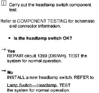

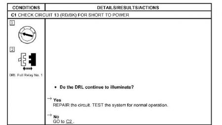

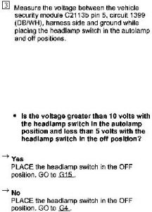

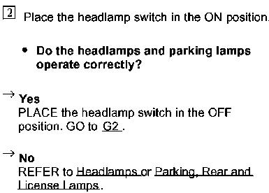

Okay. Lets try this. I have posted the first four steps along with the figures that go along to help you out. I had to separate them to enlarge them so let me know if this helps. If one of the steps lead you into another test or step 5 or beyond let me know, as I only have first 4 steps posted. FIRST STEP FIGURE
https://images.2carpros.com/forum/automotive_pictures/261618_6_1.jpg
SECOND STEP FIGURES
https://images.2carpros.com/forum/automotive_pictures/261618_5_1.jpg
THIRD/FOURTH STEP FIGURES
https://images.2carpros.com/forum/automotive_pictures/261618_7_1.jpg
STEP 1
https://images.2carpros.com/forum/automotive_pictures/261618_Noname_17.jpg
STEP 2
https://images.2carpros.com/forum/automotive_pictures/261618_Noname2_4.jpg
STEP 3
https://images.2carpros.com/forum/automotive_pictures/261618_Noname3_2.jpg
STEP 4
https://images.2carpros.com/forum/automotive_pictures/261618_Noname4_1.jpg

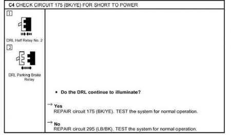

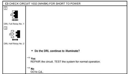

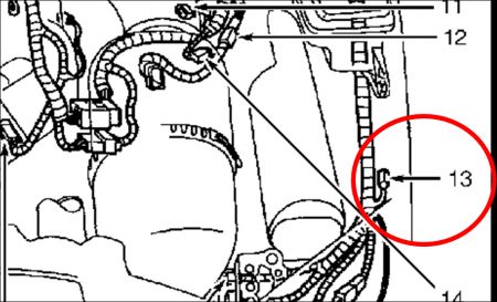

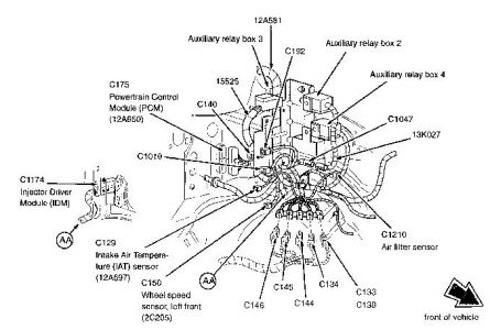

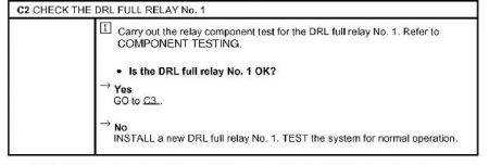

Okay, it sounds like there is a short somewhere in the wiring for the daytime running lights. Sooo, here is what we check now.
https://images.2carpros.com/forum/automotive_pictures/261618_3243_1.jpg
https://images.2carpros.com/forum/automotive_pictures/261618_Noname_18.jpg
https://images.2carpros.com/forum/automotive_pictures/261618_Noname2_5.jpg
TEST RELAY BY SIMPLY SUBSTITING ANOTHER RELAY INTO IT'S SPOT. YOU CAN ALSO HAVE AN AUTOPART STORE TEST IT FOR YOU. LOCATION OF DRL RELAYS:
https://images.2carpros.com/forum/automotive_pictures/261618_Noname_19.jpg
https://images.2carpros.com/forum/automotive_pictures/261618_re_1.jpg
https://images.2carpros.com/forum/automotive_pictures/261618_Noname3_3.jpg
https://images.2carpros.com/forum/automotive_pictures/261618_Noname4_2.jpg
Oh and by the way, donations are not mandatory, just very much appreciated. The small donations we receive and word of mouth are the only two things that enable us to help others. I certainly hope we resolve the issues here without you having to spend a fortune at a dealer. Just post your results of these tests and I will follow up. Don't worry, I won't leave you hanging. I will stick it out 'til the end until we fix it.

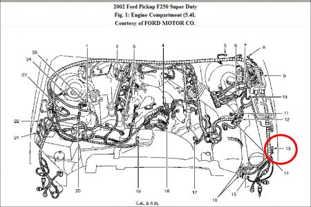

I do have one question. I have a hard time locating all the relays. I do have Chiltons on line and am looking for K370 DRL relay 1 now.
I am a bit shy of repair shops now. I just had to pay $914.00 for a fuel pump in a 1996 Chevy S-10 (I wish I knew how to diagnose that one). They told me I needed new rear U joint as well. I installed both rear and front myself instead of paying them another arm and leg. All it cost was the cost of the u joints, a few hours ( I needed to buy a 12 ton Hyd Jack at Harbor Freight to break loose 12 year old u joints from the drive shaft. Small price to pay, especially I have wanted an hydrauic jack for some years.)
Dec 7, 2008 at 8:57 AM
BLUELIGHTNIN6
  • 16,542 POSTS
Sorry , that was my mistake. Please re-read my previous post. I edited it and now have the locations of relay and how to test it for you.

Thanks for the Relay location diagram. I did find it in Chiltons too, but I used yours.
I did do step 1, removing DRL relay 1. Lights stayed on.
By the way, I know in the past I have set the parking brake and the DRL stayed on then too.
Since in check 1 it says I now need to repair the circuit. Is that true. Is that something I can do?
Dec 7, 2008 at 9:49 AM
BLUELIGHTNIN6
  • 16,542 POSTS
Step 1 is to Check Circuit 13 (red/black wire) for short power.
You removed the relay and the lights STILL stay on? ?
Remove BOTH of the DRL relays. Lights shouldn't be able to stay on without the relays..
There is a DRL Parking brake relay that may need to be checked..hmm.
I tell you what, if removing these 3 relays still allows the lights to remain on, I am going to say that you have stumped me. But I will go ahead and invite one of the techs with more experience with electrical issues into this posting so we can get this fixed. If you don't care go ahead and remove BOTH of the DRL relays and the Park Brake relay which is also located in the auxiliary relay box No. 2
