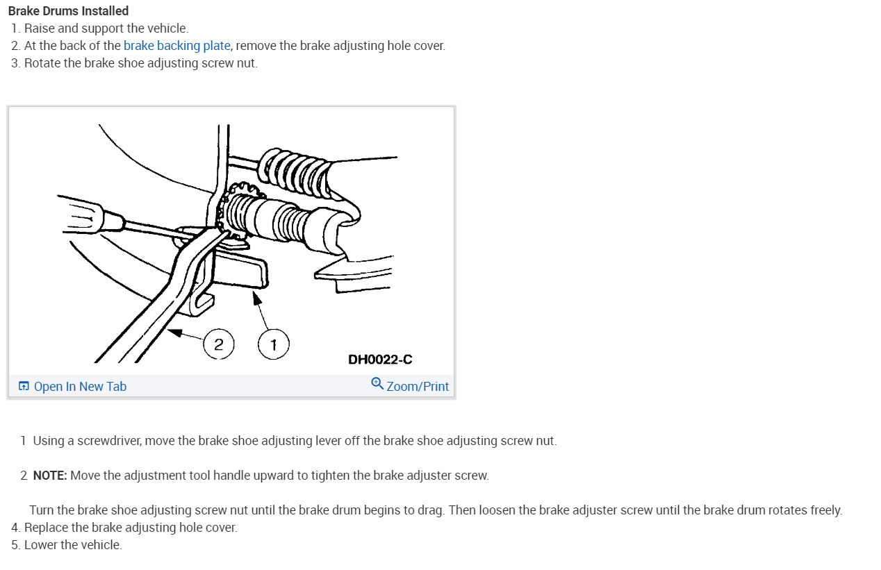

How do I adjust the emergency brake?
Aug 13, 2010 at 6:25 AM
BLUELIGHTNIN6
  • 16,542 POSTS
The adjustment is done at the parking brake show here is a diagrams to help show you. Check out the diagrams (Below). Please let us know if you need anything else to get the problem fixed.

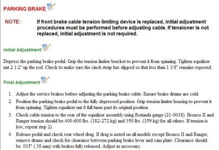

Brakes problem
2001 Ford F250 Four Wheel Drive Automatic 98,000 miles
How do I adjust the emergency brake cables? When the emergency brakes are applied The truck is put into gear the truck roles as if I have no breaks at all
All the break pads have been done recently .
If there is an adjustment where are they located or what has to be done to correct this problem??
Jim

PARKING BRAKE
Parking Brake Shoe Adjustment (Expedition, Excursion, Explorer, Explorer Sport, Explorer Sport-Trac, Mountaineer & Super Duty Pickup)
NOTE:On all models except Excursion, Escape, Explorer, Explorer Sport, Explorer Sport-Trac, Mountaineer and Super Duty Pickup, parking brake system is self-adjusting and does not require adjustment.
Using Brake Adjustment Gauge (D81L-1103-A), measure inside diameter of drum portion of rear disc brake rotor. On Excursion and Super Duty Pickup, using parking brake adjuster screw, adjust parking brake shoe and lining until they drag against parking brake drum. On all other models, adjust parking brake shoe and lining to .020" (.508 mm) less than drum measurement.

how to you adjust the parking brake on a 1999 ford 250 four wheel drive.
Jul 29, 2019 at 8:09 AM (Merged)
2CARPRO JACK
  • 11,533 POSTS
If it has 4 wheel disc brakes the ebrake is in the center of the rotor and you will need to remove the rotor to adjust the shoes.If drums, try adjusting the shoes until they barely rub the drum and it should bring the ebrake around. In a SuperDuty or Excursion you don’t have to remove the rotors to adjust e-brakes, unless you are replacing the e-brake shoes.

My parking brake doesn't hold anymore
Can I adjust it? How?
