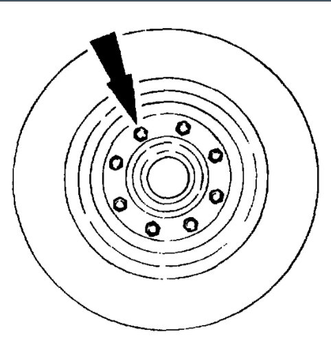

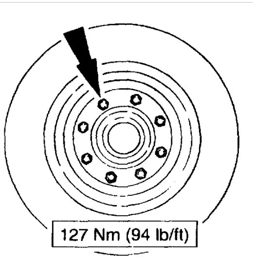

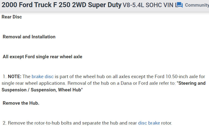

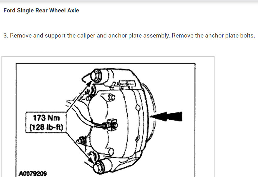

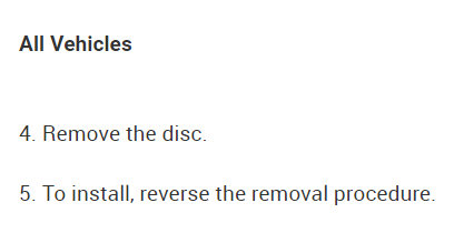

I have the caliper off and brake line off, now how do I get the rear rotor off? Please and thank you.

Here is a tutorial showing what is involved in removing the rear brake rotors:
https://www.2carpros.com/articles/how-to-replace-rear-brake-pads-and-rotors
I've attached below picture steps on how to remove the rotors for your truck. Hope this helps and thanks for using 2CarPros.
