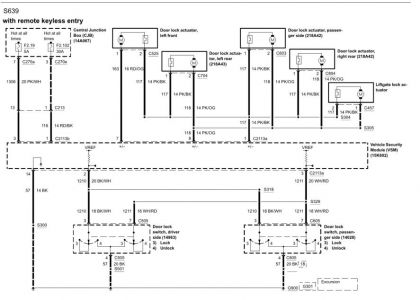

I have a 2000 F250 Super Duty 4 door with electric windows, locks and keyless entry. Both of the doors on the drivers side are damaged so I bought a back and front door off a 2003 model. Everything seemed ok until I came to the wiring`in the doors. The connectors are different and I noticed that my existing doors (2000 model) have extra wires compared to the new doors (2003 model). What do you subjest? Is There somewhere on the web I can find a wiring diagram for the 2003 doors?
Any help is much appreciated.

Below is wiring diagram for the 2003 F250 door with keyless entry. Let me know if you still need assistance.
https://images.2carpros.com/forum/automotive_pictures/261618_Noname_218.jpg
