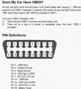

i just changed gpr on the 7.3 L powerstroke and now it won't start , started before i changed the gpr and its the right part also i don't here the fuel pump kick on like before and glow plug light don't come on and when i plug superchip into the data conn. it comes on alright and when i go to read dtc it makes wierd noise and error comes up / check connections. i checked fuses, relays, connections, so what ever it is its messing with my fuel pump, glow plug light on insterment panel, and won't let me read dtc on programmer. i also checked fuel cut off switch. i hope you can give me something on this i'm stranded at home and need to go to work. thanks Dan Sackett

http://www.youtube.com/watch?v=Rgc9VSR9fNQ&feature=related Try this if the batteries are as old as this truck... Also check power and grounds at the DLC here's the terminal ID's
https://images.2carpros.com/forum/automotive_pictures/62217_n_4.jpg

when i plug my programmer into it ,it comes on and every thing but soon as i go to read dtc it throws a error up saying ck connections. what connectiions

First I would need the specs of your tool, most wont power up if pin 16 is dead, if the pin 4 or 5 which are the grounding pins have problems, errors could be possible, check those first.
