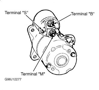

My 1999 Ford F250 will not start. The starter makes no noise when I turn on the ignition. I tried to jumpstart with another vehicle, still does not start. I also checked fuses related to the start and ignition and they seem OK.
I think the starter is dead. Where is the starter located in the engine compartment and how can I find instructions how to replace it?
Thanks for your help.

STARTER MOTOR
Removal & Installation
Disconnect negative battery cable. Raise and support vehicle. Remove starter solenoid terminal cover. Disconnect starter solenoid wire connections. On 4.2L engines, remove starter motor mounting nut and ground cable. On all engines, remove starter motor mounting bolts. Remove starter motor. To install, reverse removal procedure. Ensure negative battery cable is installed in proper location. Tighten fasteners to specification. See TORQUE SPECIFICATIONS .
ENGINE DOES NOT CRANK OR RELAY CLICKS
Verify battery condition. If battery is okay, measure voltage between each Red wire at starter relay and ground. Battery voltage should be present at one Red wire only. If battery voltage is present on one Red wire, go to next step. If battery voltage is not present on either Red wire, repair or replace Red wire between battery and starter relay cable. Check system operation.
Measure voltage between starter motor solenoid "B" terminal and ground. See Fig. 3 . If battery voltage is present, go to next step. If battery voltage is not present, clean and tighten battery and solenoid terminal connections. If battery voltage is still not present, replace positive battery cable. Check system operation.
Fig. 3: Identifying Starter Solenoid Terminals (Typical)
https://www.2carpros.com/forum/automotive_pictures/266999_250_5.jpg
Using jumper wire, connect one end to positive battery terminal and with other end, momentarily touch starter solenoid "S" terminal. See Fig. 3 . If solenoid engages, go to next step. If solenoid does not engage, replace starter motor. See STARTER MOTOR under REMOVAL & INSTALLATION. Check system operation.
Using heavy gauge jumper wire, connect one end to positive battery terminal and with other end, momentarily touch starter solenoid "M" terminal. See Fig. 3 . If starter spins, go to next step. If starter does not spin, replace starter motor. See STARTER MOTOR under REMOVAL & INSTALLATION. Check system operation.
Disconnect starter relay connectors. Disconnect starter motor solenoid connectors. Measure resistance of Red wire between starter relay and starter solenoid. If resistance is less than 5 ohms, replace starter relay. If resistance is 5 ohms or greater, repair or replace Red wire between starter relay and starter solenoid. Check system operation.

Thanks for the response. Do you have to access the starter from underneath the truck to remove it?
Thanks again.
Thursday, April 15th, 2010 AT 3:38 PM
DAVE H
  • 13,384 POSTS
Yes the starter is accesable from under the vehicle !
