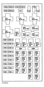

pump and filter ok. the safty shut off switch is not triped.With a test light I have no power to the pump even with the engine turning over.

check fuse # 10 in battery fuse/junction box Fuel Pump Relay In battery fuse/junction box.
https://images.2carpros.com/forum/automotive_pictures/266999_fuse_10.jpg
