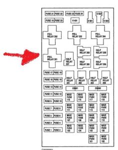

I AM TRYING TO TEST THE FUEL PUMPS. I AM NOT GETTING ANY PRESSURE AT THE FUEL RAIL AND I CAN NOT HEAR THE PUMP TURN ON HOW DO I TEST FOR POWER AT THE FUEL PUMPS

check fuse 10 in engine compartment fuse box .. check/replace fuel pump relay is same fuse/relay box
https://images.2carpros.com/forum/automotive_pictures/266999_250_2.jpg
check Inertia Fuel Shut-Off Switch ..Under right side of dash Try powering the pump direct from power supply using pink/black wire from inertia switch .. also check the ground is good !! hope this helps
