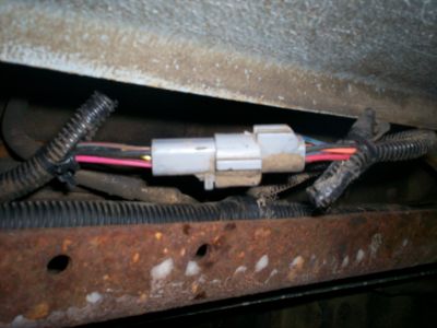

My front tank stays at empty. If I unplug the sending unit the gauge then goes past full. If I leave it plugged in and cut the ground wire and splice in another and run it to ground the gauge goes past full. Bad sending unit for the front tank? My rear tank was also staying empty and not moving. I unplugged the sending unit and it went past full on the gauge. I spliced in a wire and went to ground and now the gauge reads past full when I have the rear tank on? Both wires I used were the smaller of the 4, the yellow and white I think. Do I have 2 bad sending units?

The Yellow/White wire is correct for the sending units but in our database it is stated as Yellow/White up to the fuel tank selector switch and beyond that, the rear fuel tank should be Yellow/Blue whereas the front fuel tank is Dark Blue/Yellow.
Where did you unplug the sending unit connectors and grounded it?
One thing that seems out of place is the gauge showing past full when the connector is unplugged. Under normal curcumstances the gauge should drop to empty when the sending unit is unplugged.

At frst I unplugged the sending unit at its electrical plug in connector. I then tried to ground the female end of the plugin to the truck. The key was in the run position. As soon as I unplug the connector the fuel gauge goes all the way full. To avoid this I left it plugged in to keep the tank reading empty and cut the yellow/white wire on the sending unit side of the electrical connction. Then splicing it to another wire and running it to the negative side of the battery the gauge moves all the way past full again. Also, with the key in the run position, I put my test light into the female ends on the wiring harness side of the connectors to test for power, it never lit up on all 4 wires. The truck will run and use the fuel from both tanks. If i unplug the connector and try to start the truck it wont so it must work for the pump. Why do both tanks read all the way past full when the electrical plug in to the sending units is unplugged? Would it have anything to do with the dome light coming onvery time the brakes are pushed?

Here is what I have for the wiring at the front tank. Sending unit side Wiring harness side Black Black Black/PinkRed Gray/RedOrange Yellow/WhiteYellow/Blue
https://images.2carpros.com/forum/automotive_pictures/338784_f150fuelsending_1.jpg

That kept me wondering. If the connector is unplugged, the fuel gauge should not move from bottom of gauge.
Plug in the connectors. Turn ignition ON and then OFF again. Unplug the connector and then turn ignition switch ON. Does the gauge reading go past Full?
Problem seems to be from gauge rather than sensing unit.
With connector unplugged, test the resistance between the Yellow/White of sending unit connector and body ground. Is resistance between 5 to 100 ohms?
If possible, get 2 different resistor of 10 and 50 ohms. Connect either one in series between the Yellow white wires and turn on ignition switch. Note gauge reading. Change resistor and retest.

For the fuel gauge to register Empty, the sending unit must be providing a high resistance, most probably in the region of 100 to 105 ohms to ground.
In this instance, it could be a bad/poor ground that is increasing the resistance.
This could be related to the interior lights coming on when the brake pedal is depressed. Check the ground circuit at rear taillights. Clean and retighten them to see if the problem is resolved.

Ok, I got under the truck with my meter. With the key off I tested the Black and Blue/Yellow wire on the wiring harness side of the midship tank. I got 155 ohms. Then I went from the yellow/white wire to the gas tank as my ground on the midship tank 1494 ohm. I could not produce any results with the rear tank. I tried both the ways as the midship tank and switched the fuel to rear tank, nothing.

I do not understand the fuel gauge problem. If the connector to the sending unit is unplugged, the gauge should show Empty if the ignition switch is turned ON. You indicated it is going up past Full. This indicates a fault with the gauge or its wiring. Possibly the gauge ground is insufficient.
8 volts at the tank selector doesn't mean anythnig as the power is from the gauge and after going through the coil inside the gauge, it can drop.
Does the gauge show full when the selector is unplugged?
Use a 20 ohm resistor to ground the selector wire and check if the gauge shows any reading.
