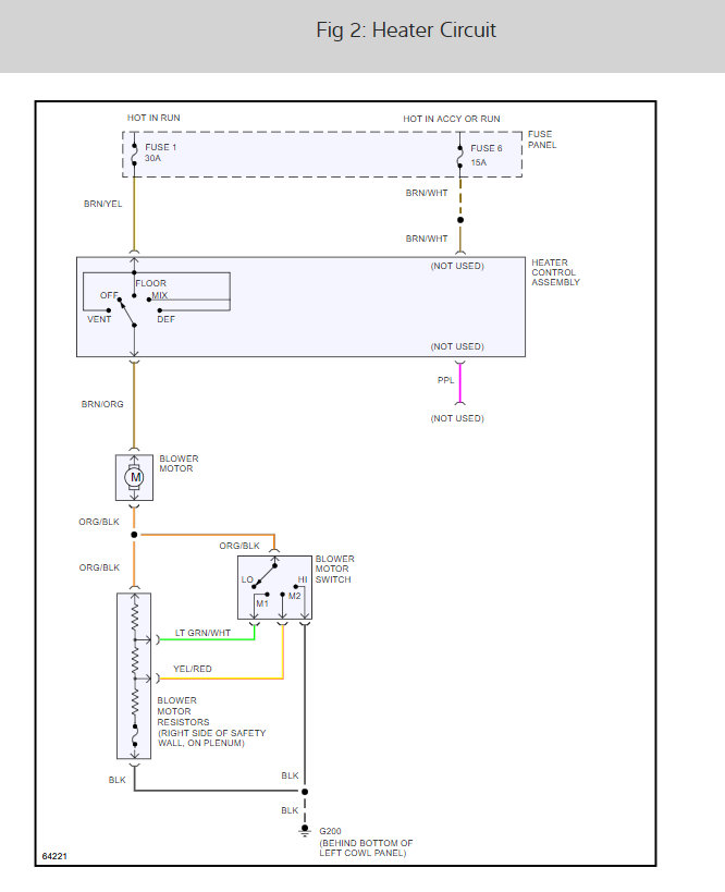

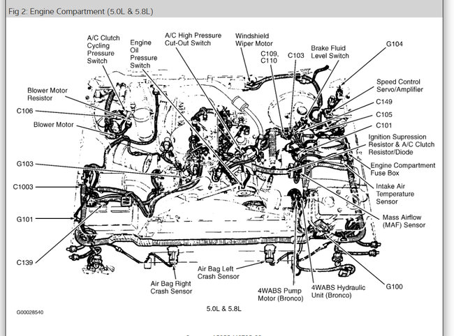

blower motor was working sporadically the past couple days. at start up it didn't work and then came on, and worked steadily without problem. since today it has not come on at all. i am hesitant to think it is the blower because of the sporadic working. i checked the fuse which is fine. does this sound like a relay/? what is the location?
Jul 14, 2009 at 8:10 PM
  • 75,992 POSTS
There's no blower motor relay here is the wiring diagrams so you can see for yourself and the location of the speed control resistor. Check out the diagrams (Below). Please let us know if you need anything else to get the problem fixed.
