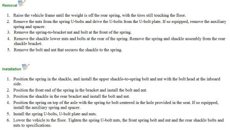

i need to know how to remove the bolt that attaches to the frame mount
Oct 28, 2010 at 6:18 AM
BLUELIGHTNIN6
Experienced Mechanic
16,542 POSTS
Oct 29, 2010 at 12:27 PM
