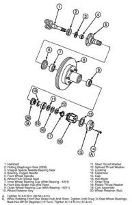

Does the operation of automatic locking hubs (the kind that uses a lever on the floor to select 2H, 4L,2L and not a dash mounted electrical switch) have any electric or vacuum component to lock or unlock the hubs, or is it strictly mechanical?

All mechanical...exploded view is below of the auto hub components..
