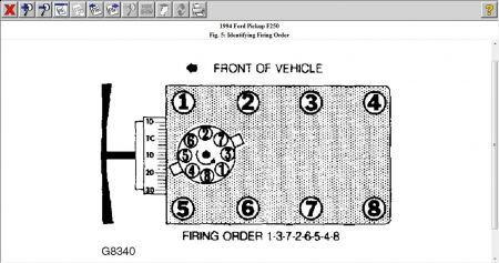

Can someone please tell me where I can find a free wiring diagram for the distributor on a 1994 F250? Much appreciated.

Incomplete vehicle description, what is the engine liter?? I got your answer waiting for you

Sorry, had a brain fart. 5.8 liter.

351/5.8L There you go buddy and Merry Christmas to you and the family
https://images.2carpros.com/forum/automotive_pictures/12900_58_fo_1.jpg
