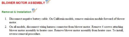

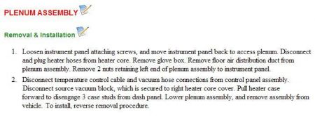

what are steps to replacing blower fan assembly for heater? Is it necessary to remove the front dash? What is ther least amount of parts to be removed in order to access and remove old blower fan and install a new one?

https://images.2carpros.com/forum/automotive_pictures/261618_Noname_1187.jpg
https://images.2carpros.com/forum/automotive_pictures/261618_Noname2_348.jpg
