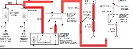

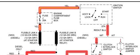

1992 Ford F250 V8 Four Wheel Drive Manual
which wire do I jump to bypass the clutch switch and do I need the other wires hooked up there are 5 or 6 there
Saturday, August 21st, 2010 AT 7:57 PM
MECHANIC
75,992 POSTS
Stay in your original post don't be reposting-jumper the red and lite blue
