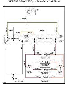

drivers door switch won.t operate either door lock, but passenger switch operates both door lock normal. replaced driver switch now have good power thru switch but won.t operate either door lock. relay?

have you checked you are getting a good ground to the switch ?
