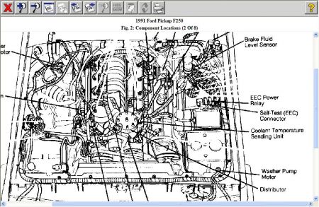

my dashboard gage holds on cold. I changed the thermostat located on the top of the block going into the radiator hose. I think there is a sencing device that sends a signal to the dashboard gage but I don' know where it is located on the eng.

Test the engine coolant temperature sending unit
https://images.2carpros.com/forum/automotive_pictures/12900_ect_5.jpg
