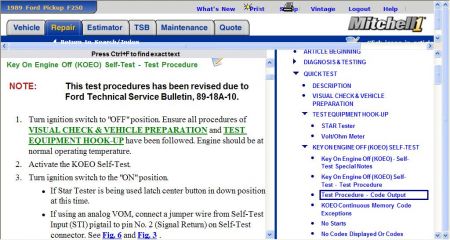

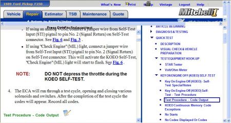

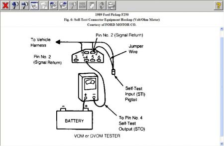

how do you pull codes
Sep 14, 2008 at 11:28 AM
Experienced Mechanic
75,988 POSTS
See below
