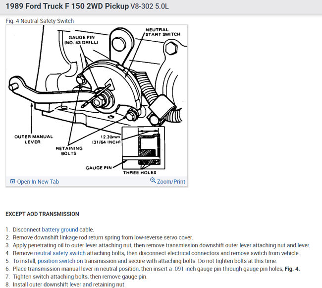

where do the wires go to and from for neutral saftey switch. I have power but wont start.

The neutral safety switch is on the side of the transmission on the drivers side form the automatic transmission here is a diagram and instruction on how to replace it. For the tick shift model it is up under the dash at the upper part of the clutch pedal.
Check out the diagrams (Below). Let us know what happens and please upload pictures or videos of the problem.
