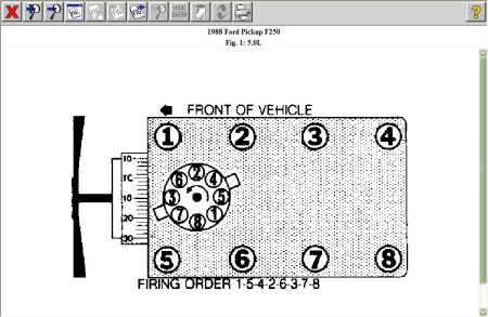

I just can't find the correct way to get this installed. If you could send some information regarding this issue, it would be greatly appreciated. It is a 1988 Ford F250. The motor is a size 302. 2 Wheel drive with a V8 Engine. Pictures would also be great if you could send those along with it....

Remove distributor Put the engine no. 1 piston on its compression/TDC-make sure timing marking O/pointer are align on the damper. Now set the distributor in making sure the rotor is pointing to the no.1 cap tower.
https://images.2carpros.com/forum/automotive_pictures/12900_timing_12.jpg
