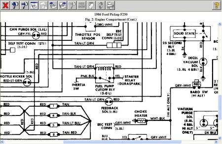

I recently aquired an 86 F250 with a 5.0. I'm not getting any fuel from the pump. I've run direct power to the pump and it works fine but no power to the inertia switch. Any suggestions?
Apr 24, 2008 at 9:53 PM
  • 75,992 POSTS
Check the fuel pump cut off relay it powers the inertia switch see below.
https://images.2carpros.com/forum/automotive_pictures/12900_fpr_1.jpg
