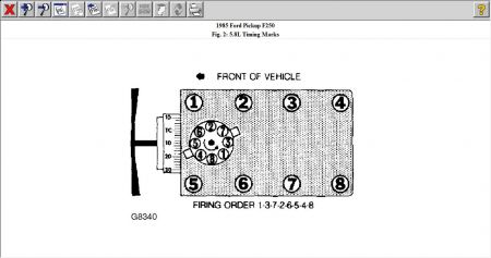

i need the spark plugh diagram Please for a 1985 F-250 351. windsor 2barrel[img:aee9fd67ff]http://www.2carpros.com/forum/automotive_pictures/421371_ebay_and_truck_058_1.jpg[/img:aee9fd67ff]

351W F/O
https://images.2carpros.com/forum/automotive_pictures/12900_351_1.jpg
