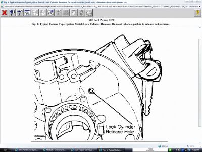

How do I remove the ignition cylinder to replace with new one

Disconnect the neg batt cable, remove the steering wheel, place cylinder in run position, use a 1/8th drill bit and push the pin as in the diagram...
