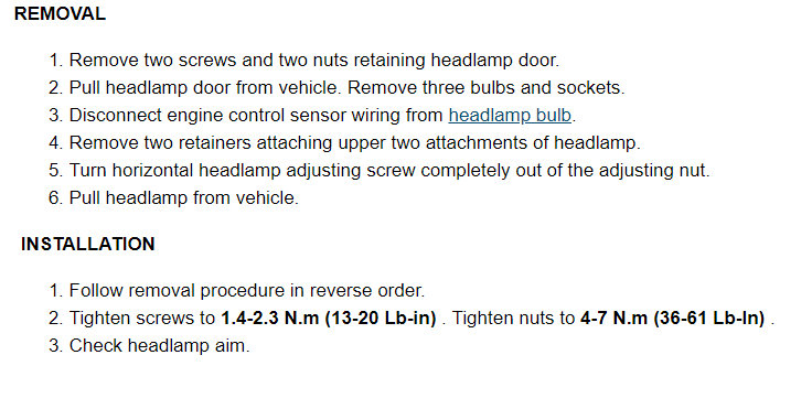

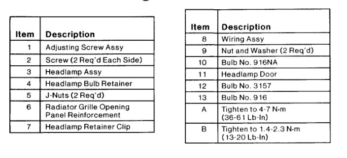

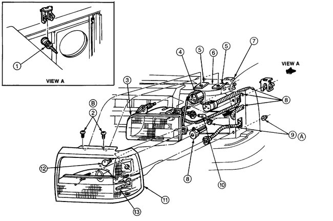

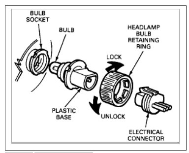

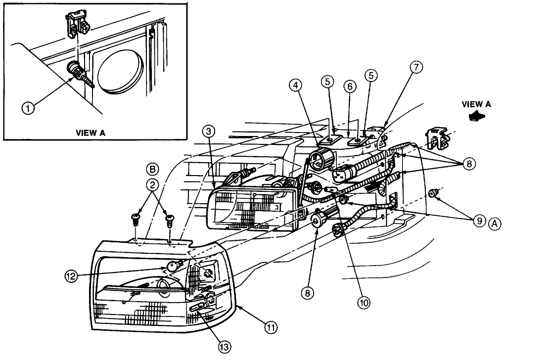

How do you remove the whole headlight assembly on a Ford F150? Water collects inside but the front is not cracked.
Jun 6, 2007 at 3:35 AM
BZNATIV
Here is a guide that will show you what you are in for when doing the job:
https://www.2carpros.com/articles/headlight-lens-replacement
Here are diagrams to show you what to do for your truck.
