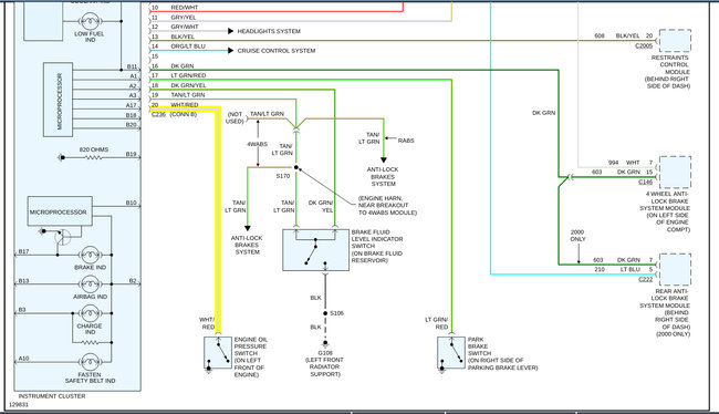

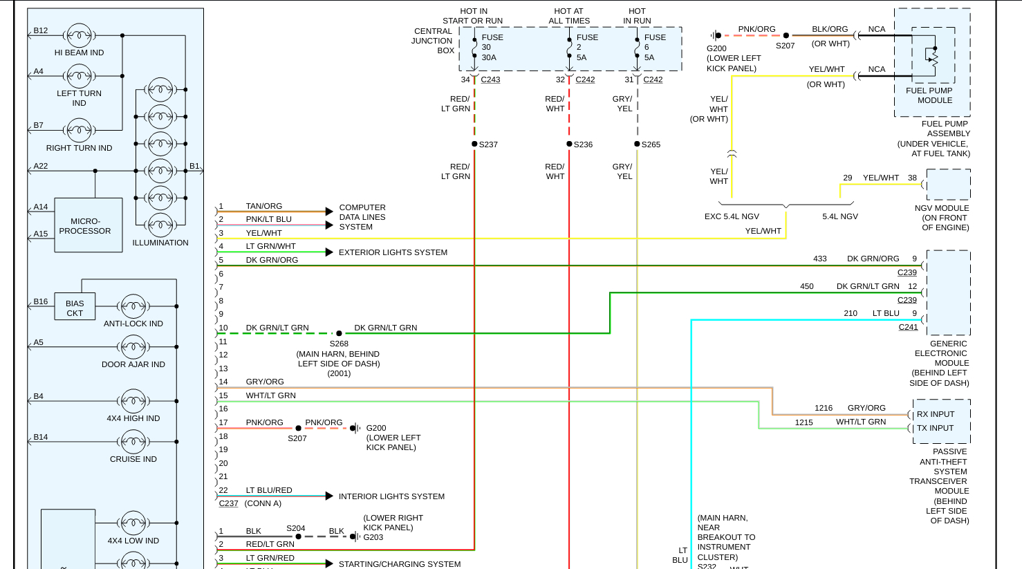

Hello, the other day I was getting ready to go to work in my truck and when I got in it started just fine, I had it running for a second before I noticed it showed no oil pressure, so I shut it off. When I turned my truck back on it would just crank and not start.I have changed the oil pressure switch as well as my oil and filter.
Any help would be appreciated.

SCGRANTURISMO
  • 4,897 POSTS

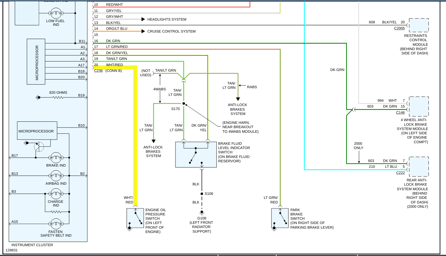

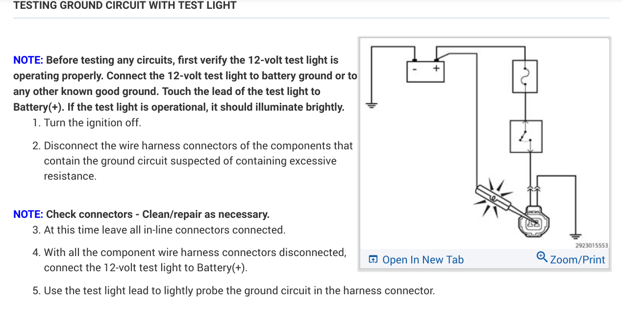

Hello again,

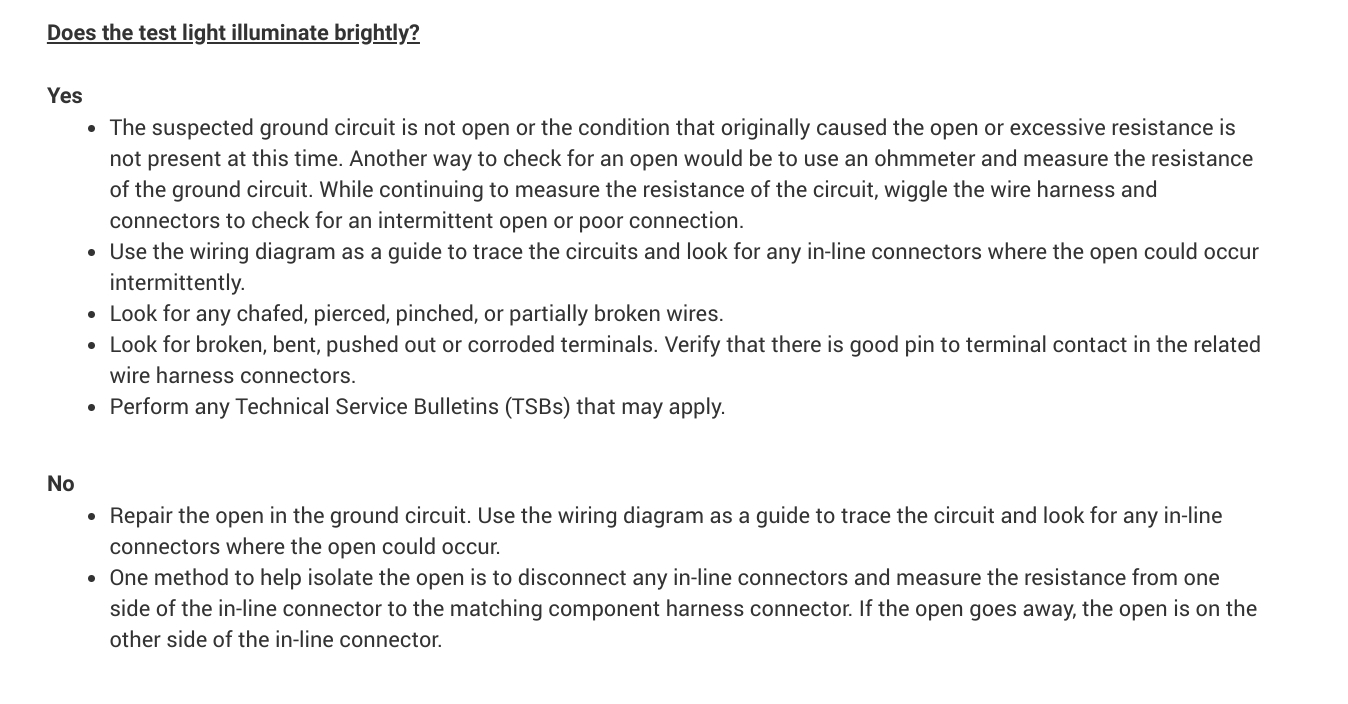

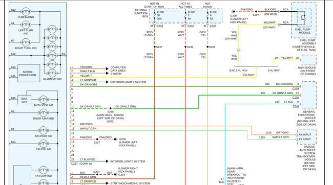

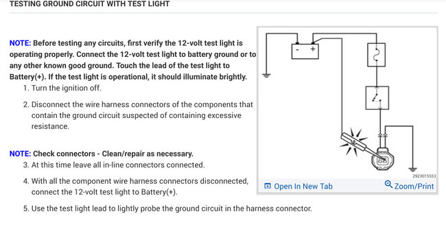

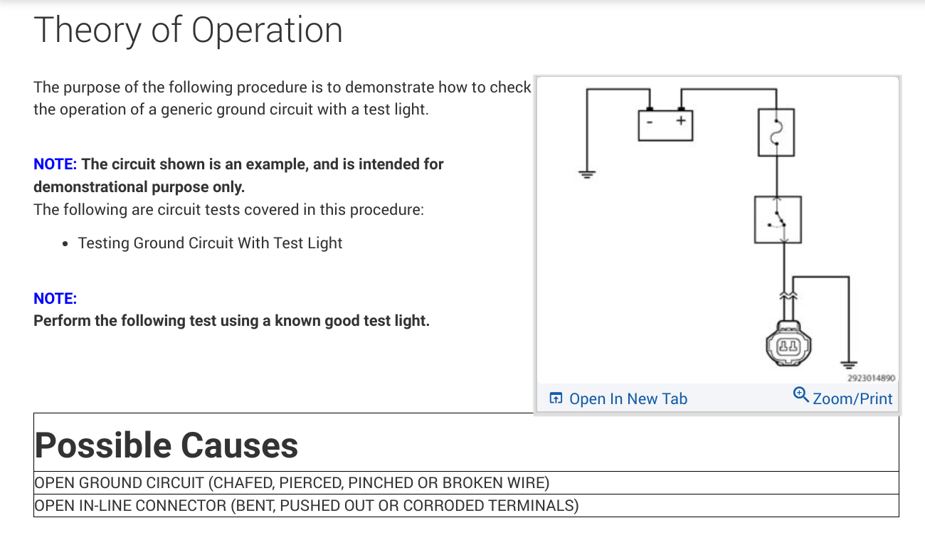

Okay, a 1/2 quart low is not going to seize one of these engines. They're pretty tough, as long as there are no vacuum leaks. They really don't like vacuum leaks. Can you check the wire attached to the oil sending unit for me? In the diagrams down below I have included the instrument cluster wiring diagram showing the engine oil pressure circuit and a guide on how to find an open in an electrical circuit for you. Please go through these guides and check the wire and get back to us with what you are able to find out.
