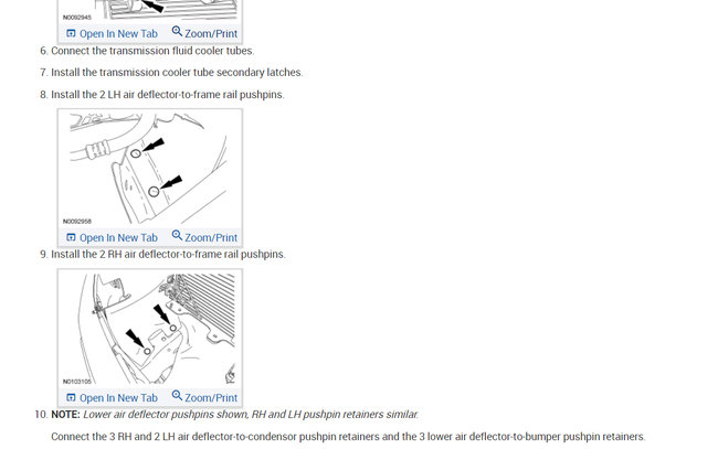

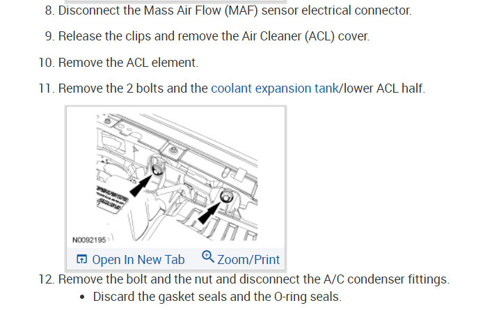

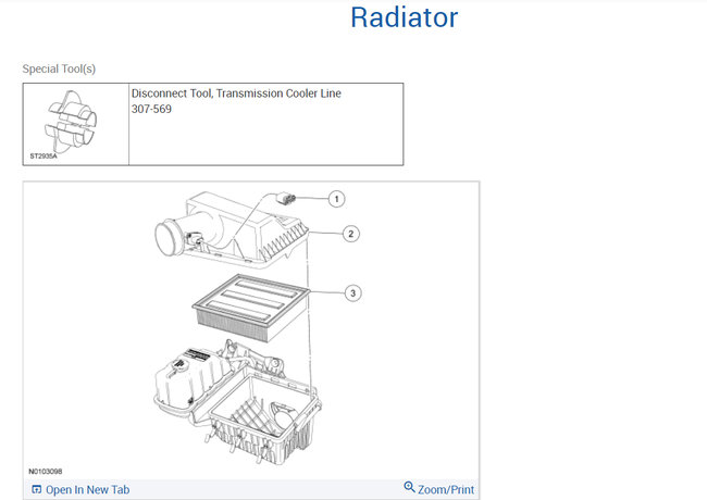

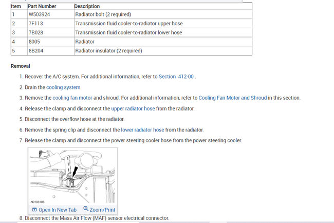

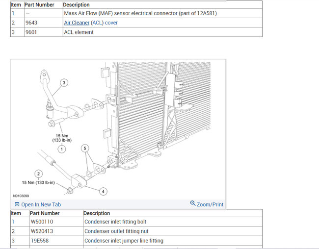

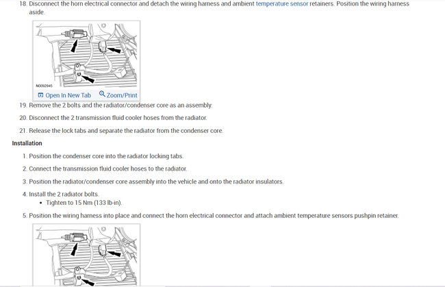

Water level in coolant recovery jugg seems to be slightly lower than when new. I attribute this to the lower part of the radiator tank leaking I need to change it out can you help me please?
Jan 20, 2010 at 12:12 AM
Good evening,

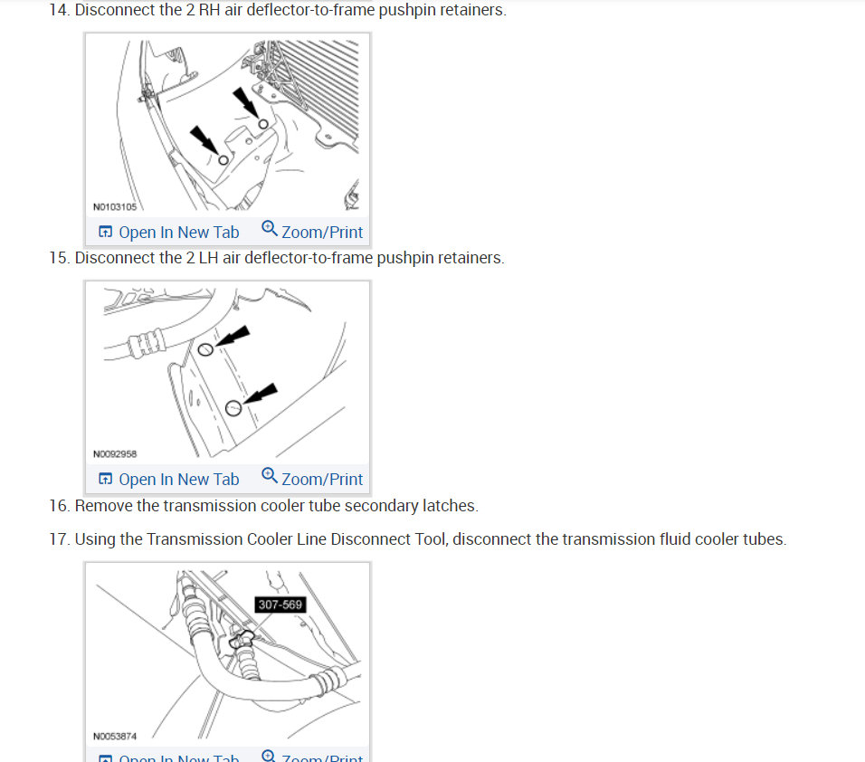

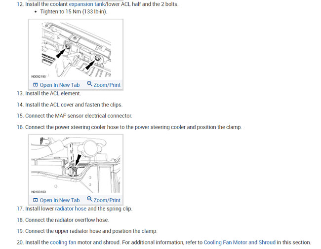

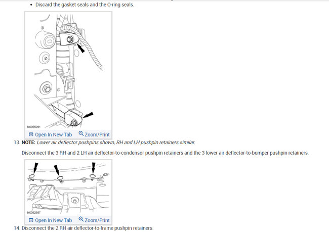

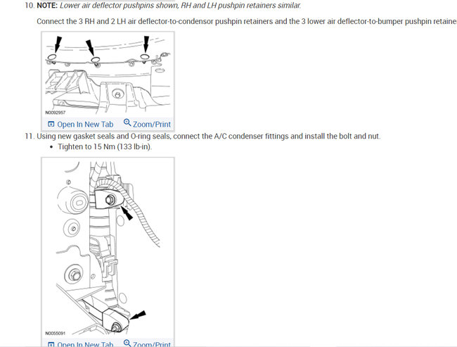

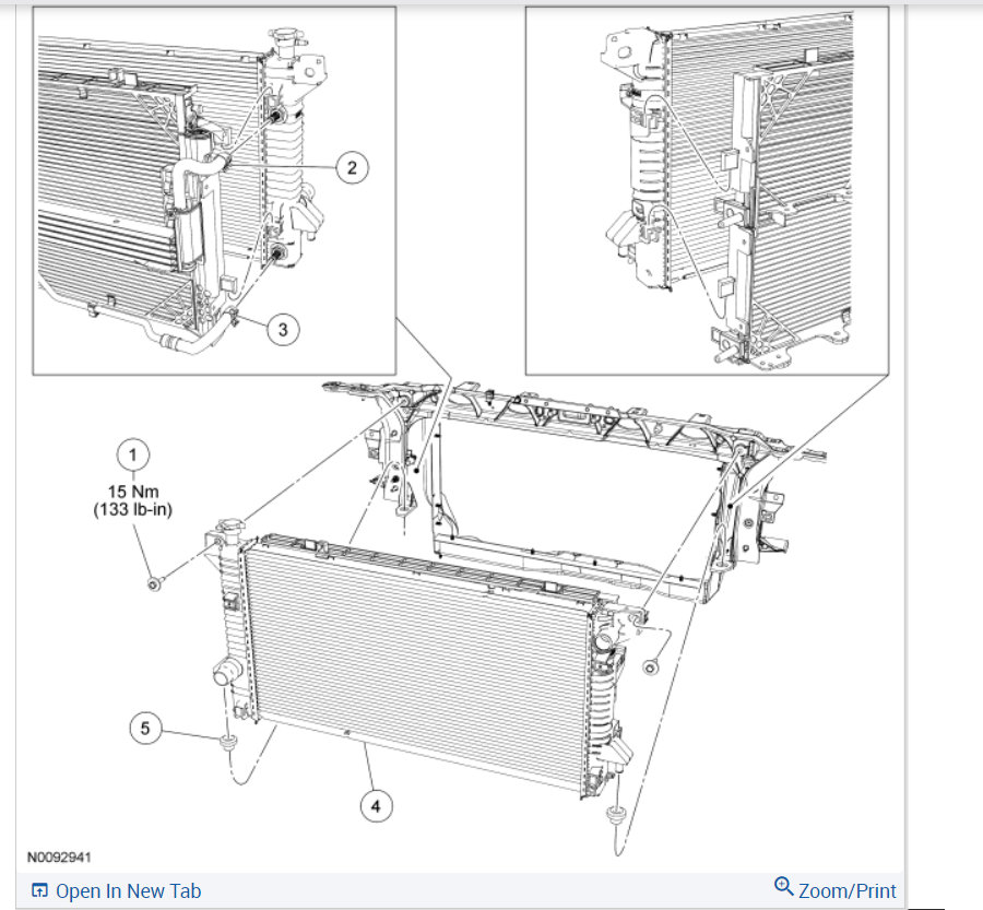

I attached the procedure for you below for the replacement of the radiator.
https://www.2carpros.com/articles/how-to-replace-a-car-radiator
https://www.2carpros.com/articles/coolant-flush-and-refill-all-cars
