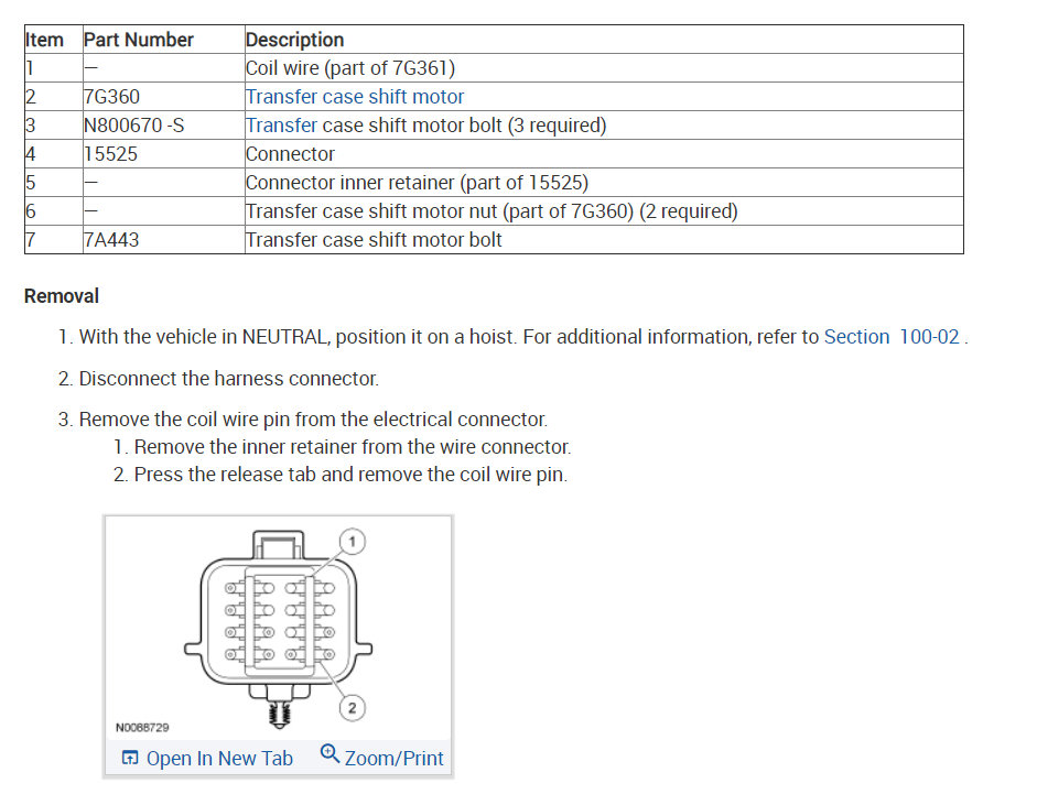

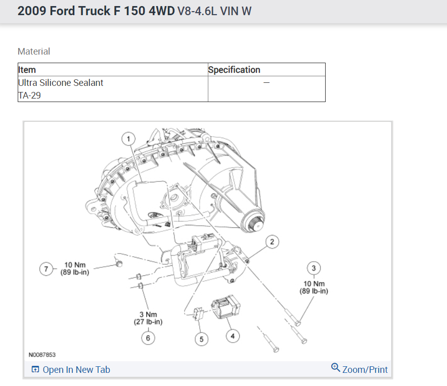

I am a law enforcement officer and our dept. recently purchased ford f150s 4x4s for use as patrol vehicles. The actuator is not working I need a new one
May 4, 2010 at 4:17 AM
  • 110,194 POSTS

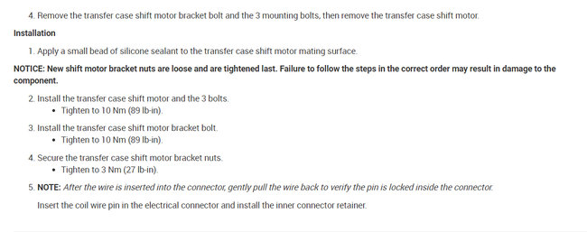

Here are step by step with instructions in the diagrams below to show you how to replace the transfer case shift actuator. Check out the diagrams (Below). Please let us know if you need anything else to get the problem fixed.
