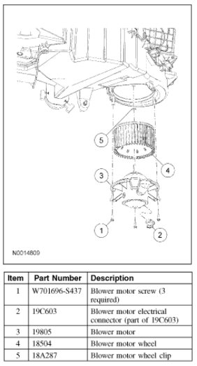

I am a mechanic for the army but i am only familiar with military vehicles. every time i turn on my ac or heater i hear a squeaking coming from the blower motor.

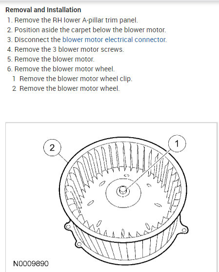

Here is the information you requested. This is a tutorial showing how to replace a blower motor:
https://www.2carpros.com/articles/blower-fan-motor-works-on-high-speed-only
Below I've attached the picture replacement steps for your truck. Hope this helps and thanks for using 2CarPros.
