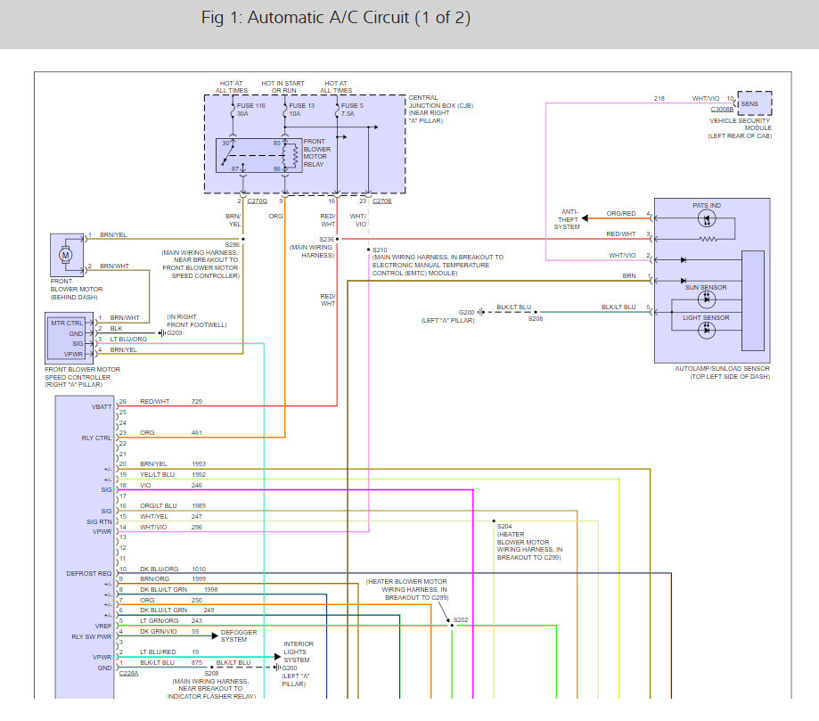

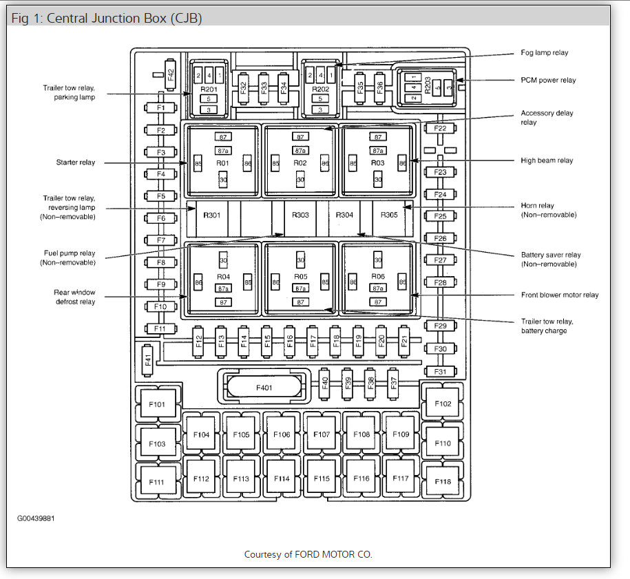

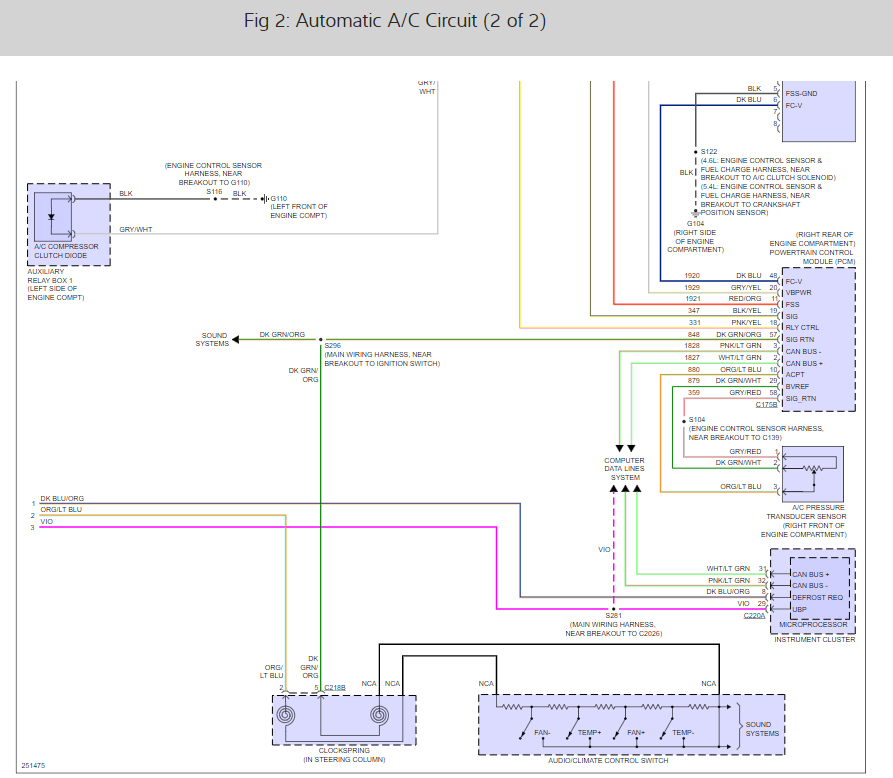

Where is the blower motor relay located on my truck and app. cost of the relay, i thank this is my problem, since the blower runs on high speed only, thanks for your help.

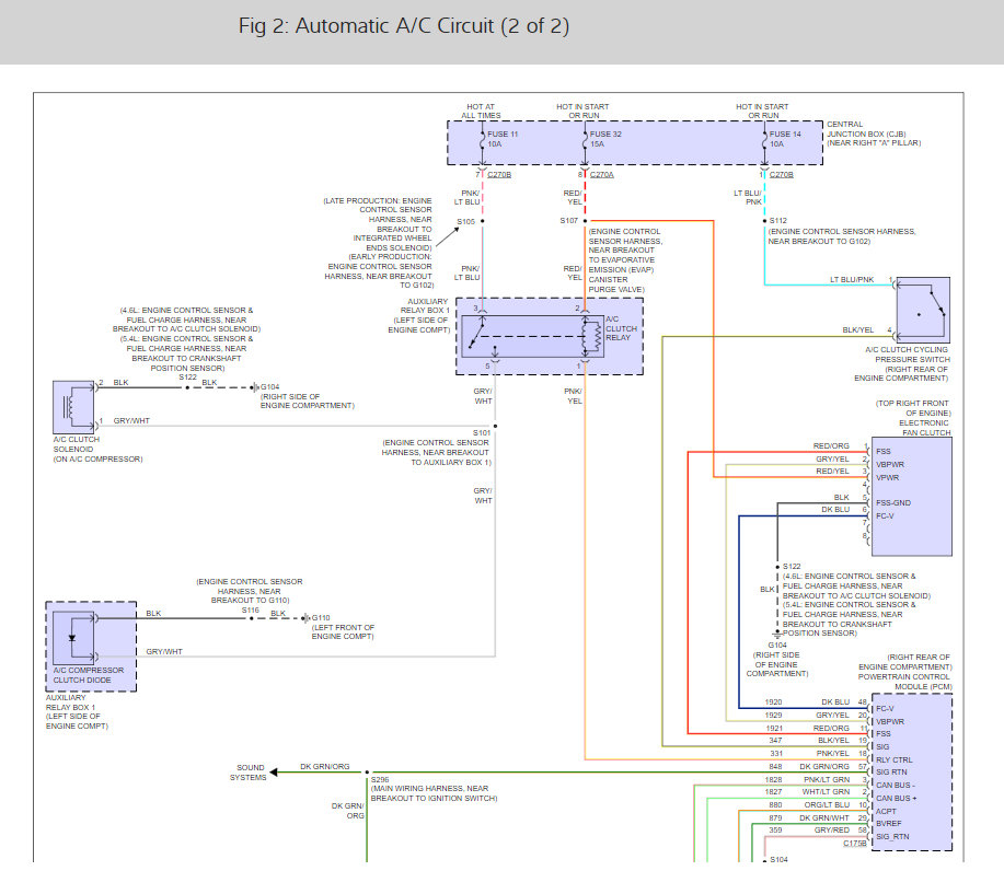

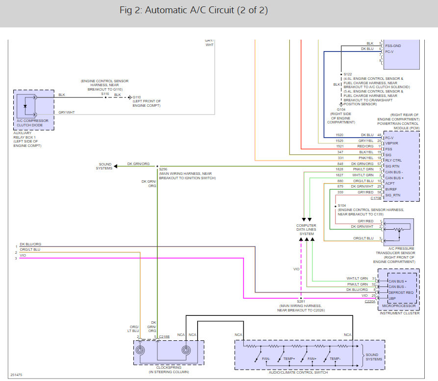

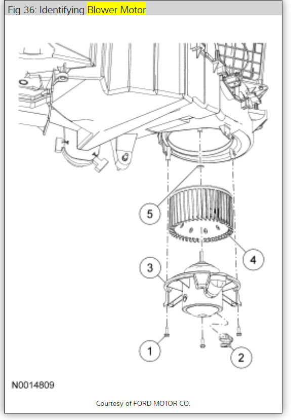

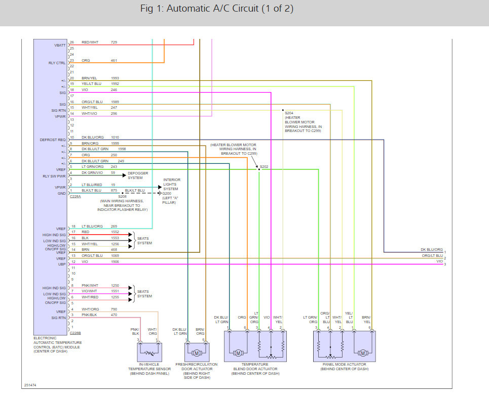

Here are diagrams below to show you how the system works and where the blower motor and relay are with guides to walk you through how to test the blower motor and relay.
https://www.2carpros.com/articles/blower-fan-motor-works-on-high-speed-only
and
Check out the diagrams (Below). Please let us know what you find. We are interested to see what it is.

I had this problem had to replace the blower motor FYI cost me $98.00 for the blower.
