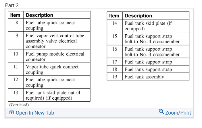

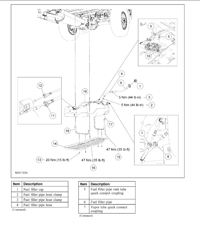

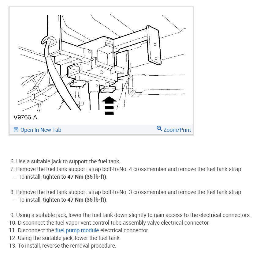

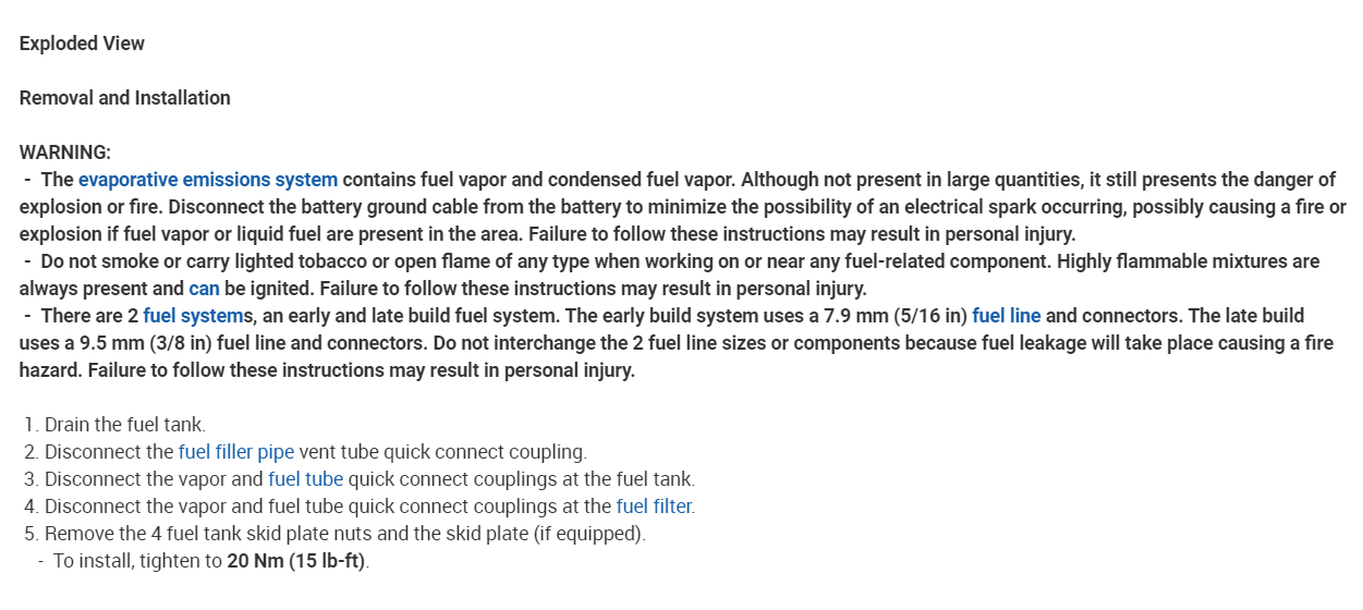

Here is a video of the tank being dropped on a similar vehicle with instruction in the diagrams below for you car.
