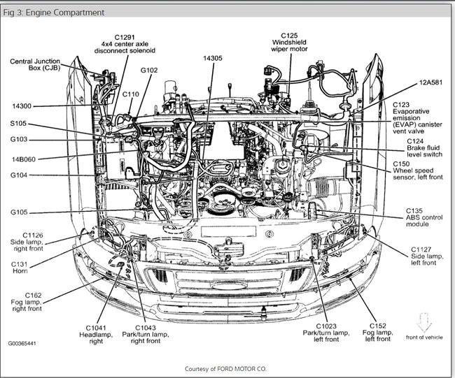

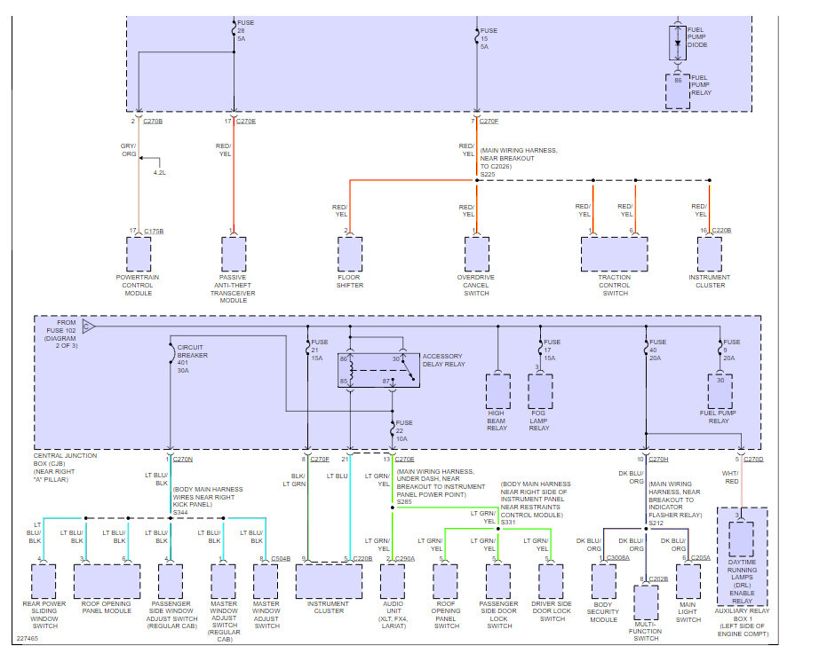

2006 5.4, while driving I'll see the dash gauges drop, radio quits, no power windows.The , cruise, lights heater motor still work tho. After a short period they jump back up or if I stop, shut it down and restart it all is fine, for a while. I also hear what sounds like a pressure relief valve releasing, and when the gauges are down and I am coming to a stop, it sounds like the tranny is grinding . No Warranty left and can't afford the dealer prices. HELP !!!
Someone mentioned the ignition switch, but I am no mechanic. How would I go about replacing the ignition switch, if you believ that might be the problem ?
Feb 8, 2010 at 5:40 PM
  • 55,561 POSTS

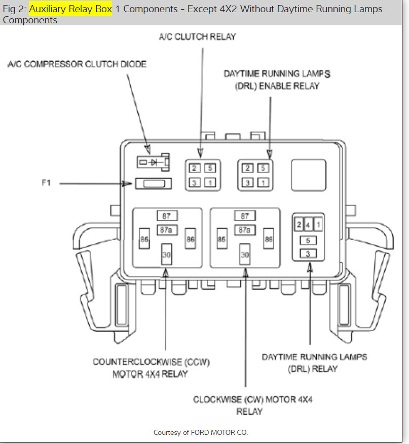

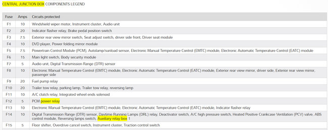

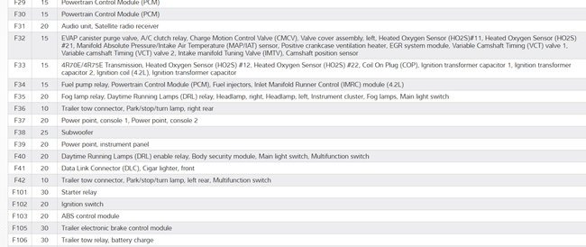

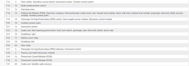

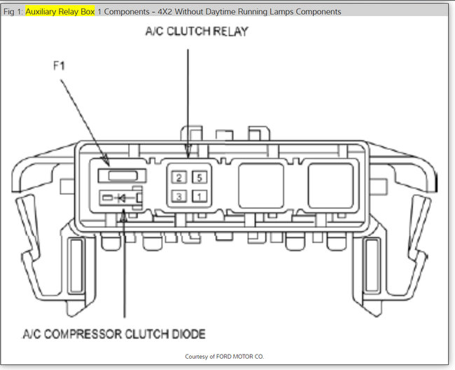

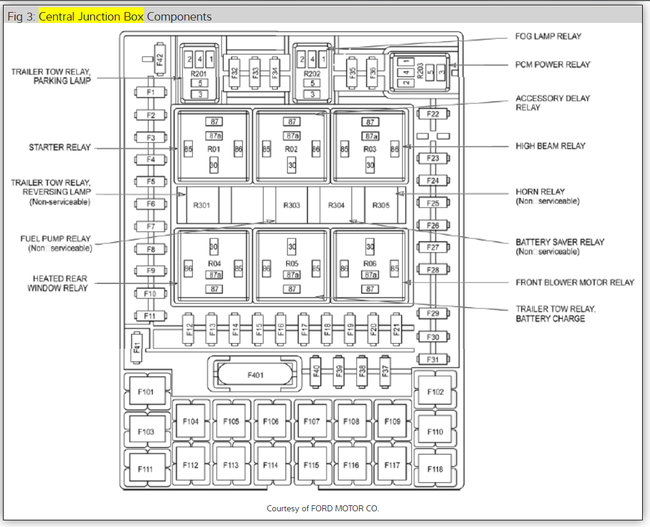

There is an accessory delay relay that powers the items you are talking about I think is going out.
Here is a power wiring diagrams and the guide to test the relay with the relay location.
Feb 2, 2018 at 9:18 AM
MICK1064
You guys are the best! that was the problem as soon as I found the relay and removed it I could see where it was super heated. Thanks again you guys are the best!
