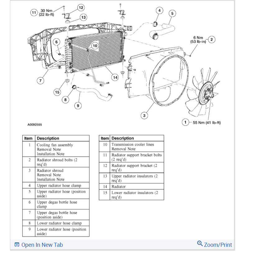

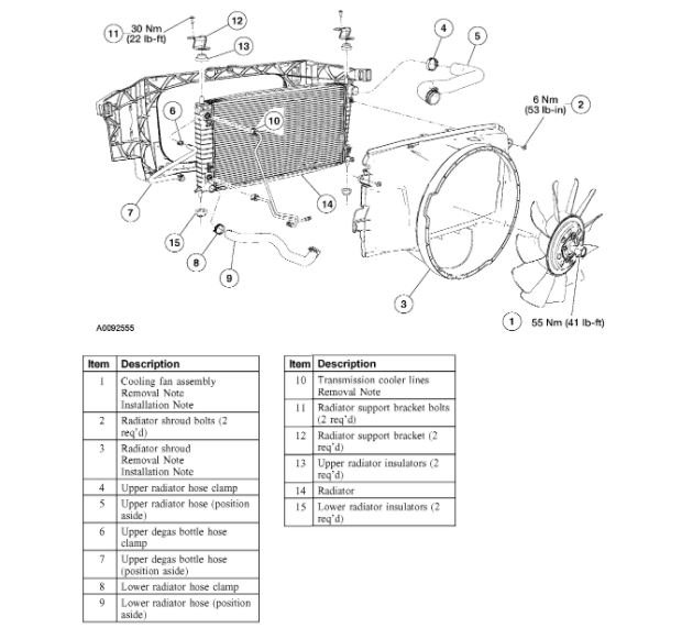

I attached pictures for you of the system below.
https://www.2carpros.com/articles/fan-clutch-removal

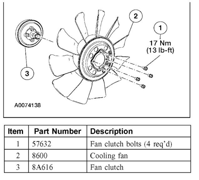

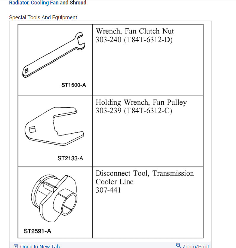

on a trip, two of the four bolts holding the fan blade came loose and fell off and the two remaining bolts broke off, the bolt studs remain in the water pump assembly. How do I remove the fan to get to the water pump assembly to remove the broken studs and replace the fan bolts.
May 7, 2021 at 4:21 AM (Merged)

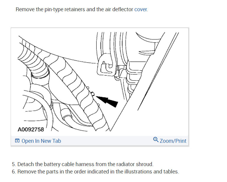

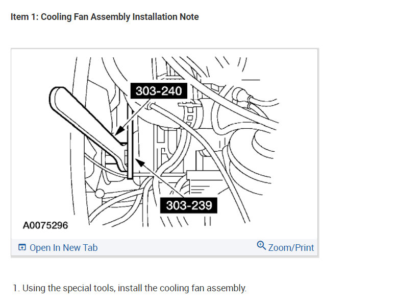

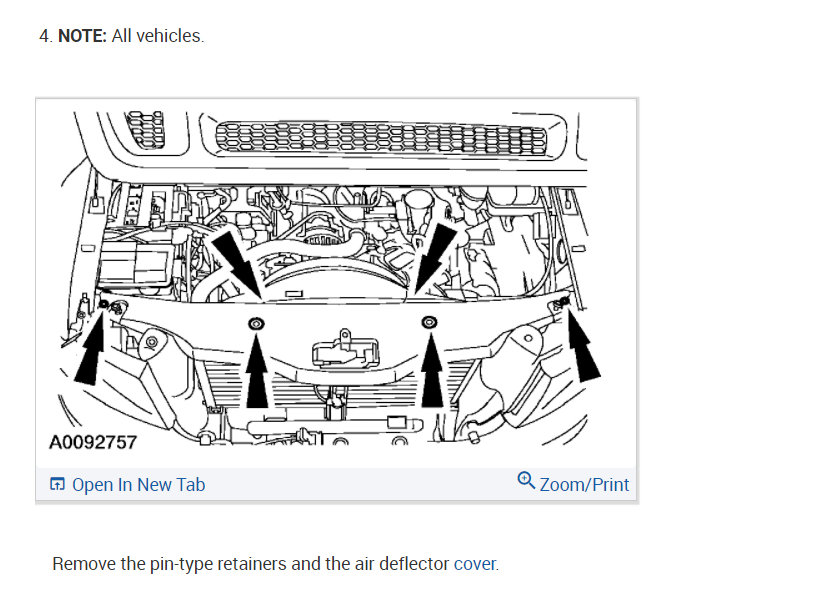

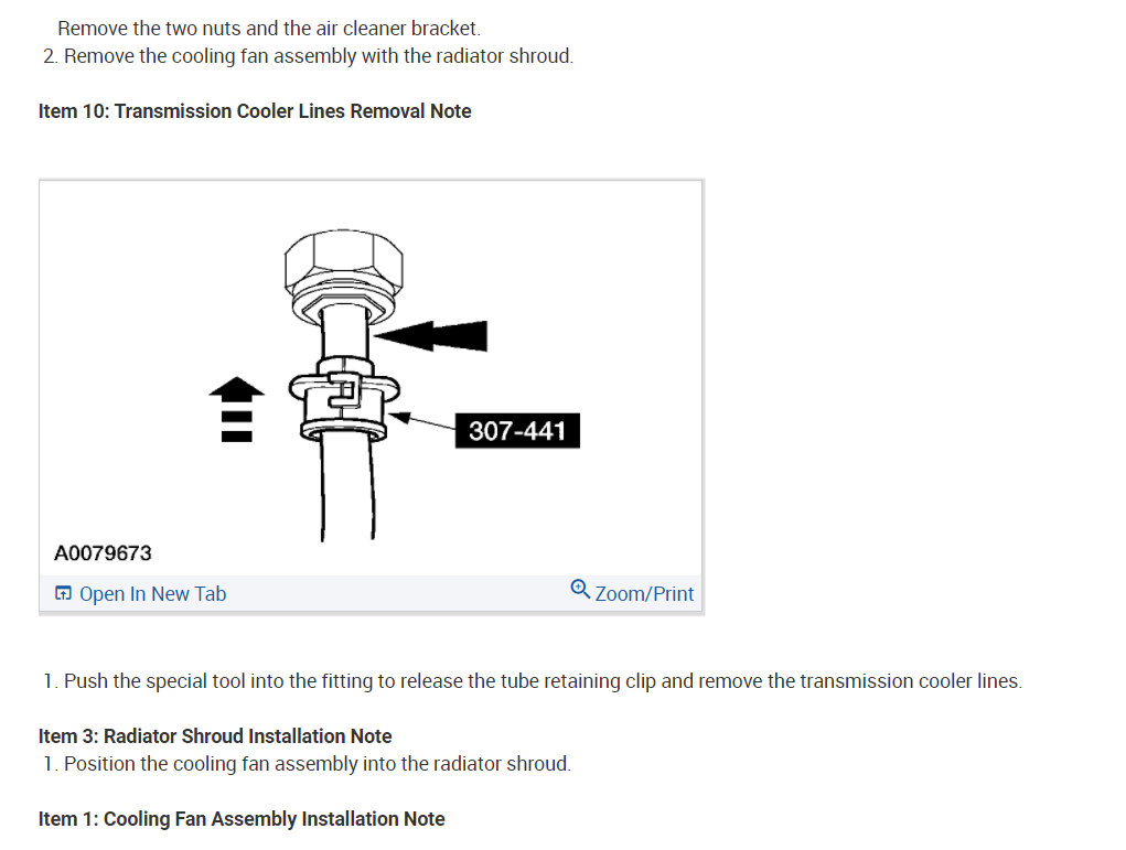

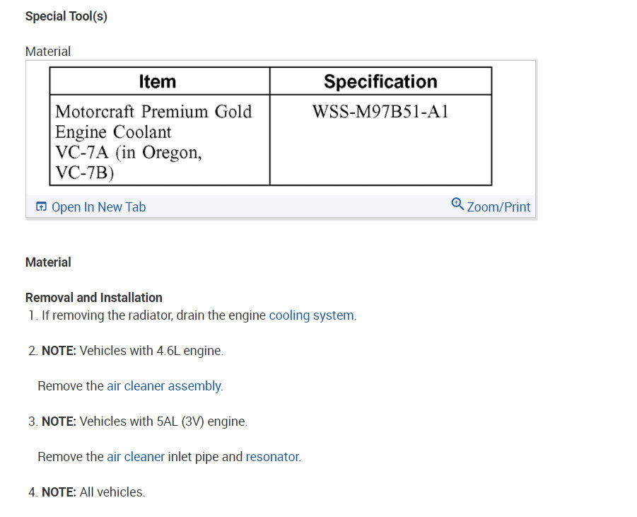

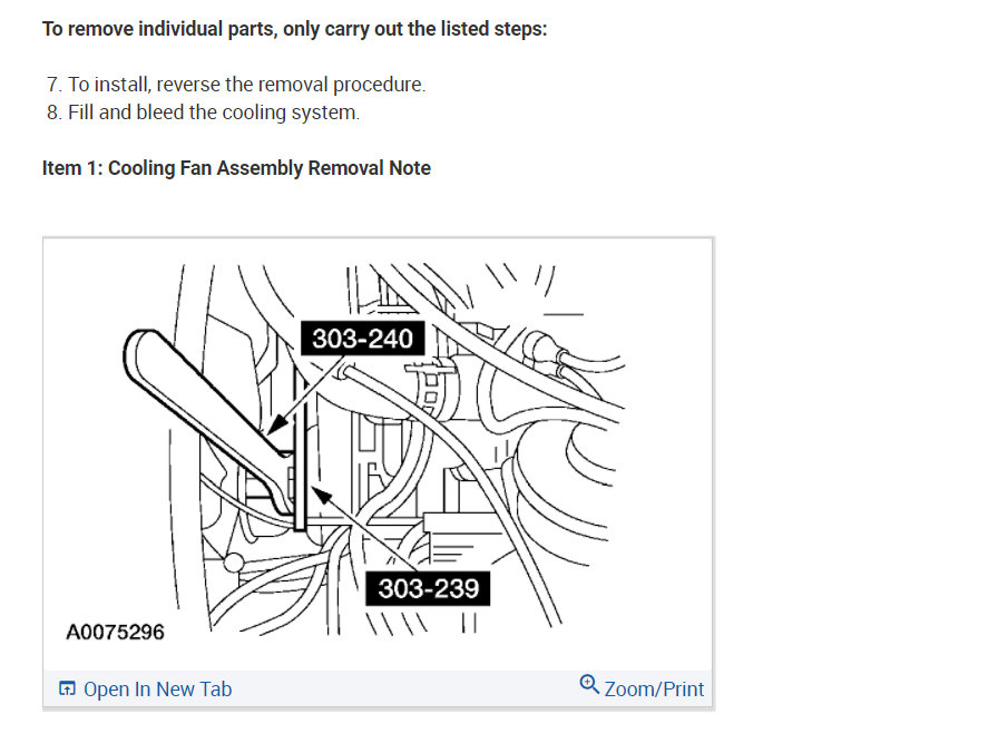

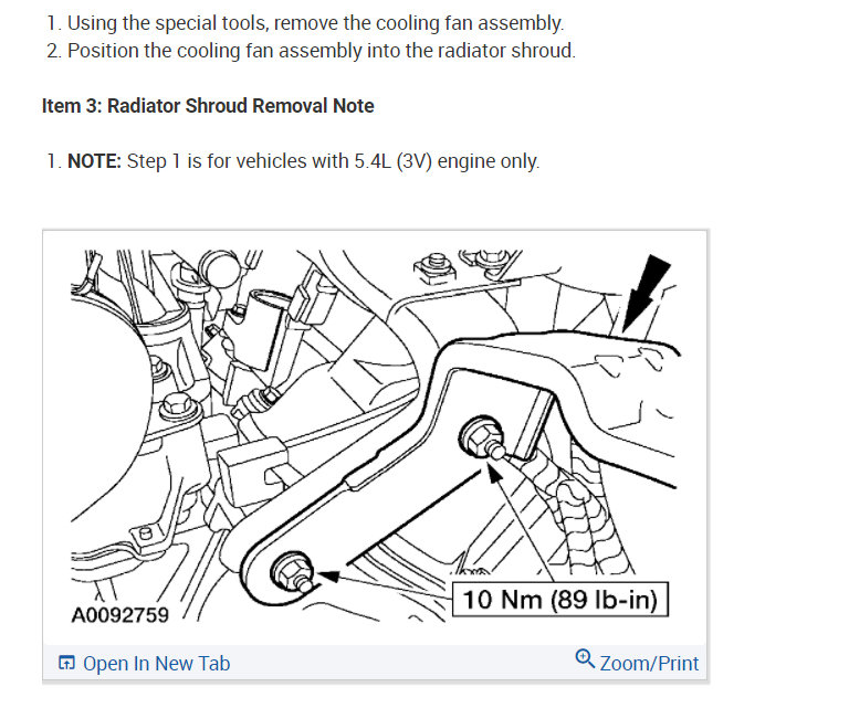

Good evening
I attached the procedure for you to remove the fan clutch. You will need those special tools to unscrew the fan clutch from the nose of the water pump. Once you release that nut and remove the clutch, all the bolts can be accessed.
https://www.2carpros.com/articles/how-a-clutch-fan-works

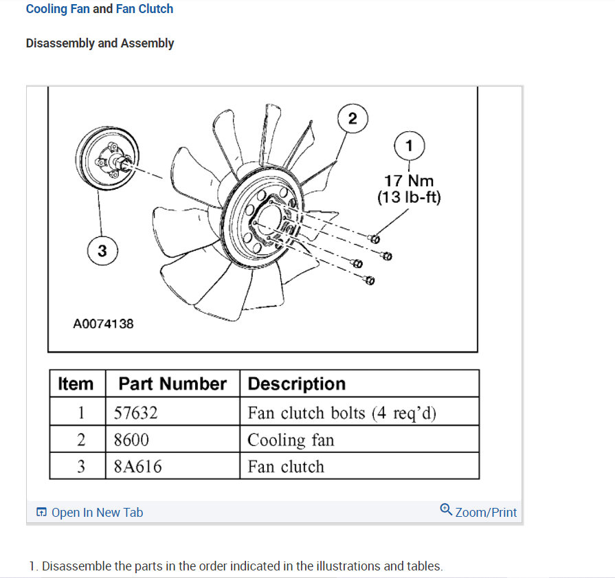

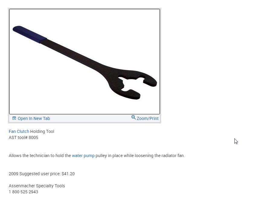

I replaced my fan clutch and do you hand tighten or torque it?
You use this tool shown and tighten it as much as you can with a wrench on the nut. Check out the diagrams (Below). Please let us know if you need anything else to get the problem fixed. Please let me know if you have questions. Thanks
