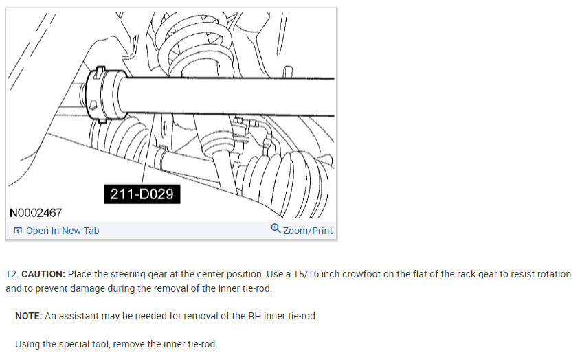

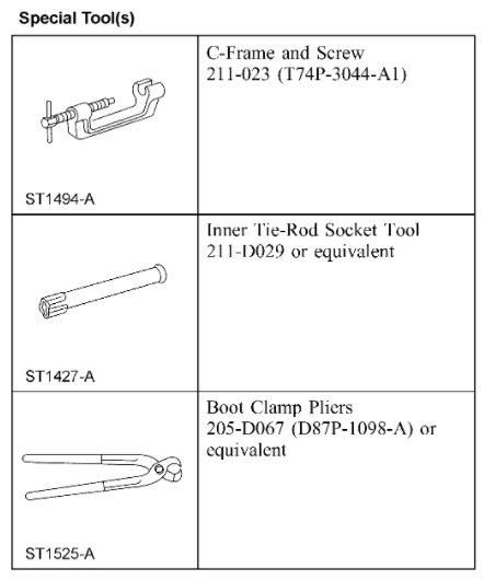

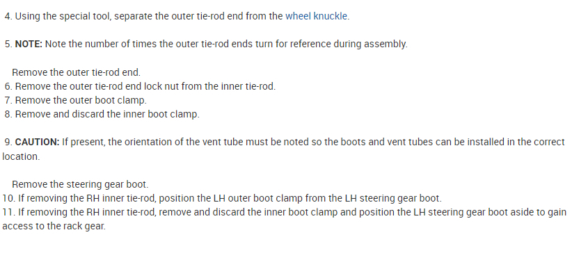

The steering binds when turning left or right in the same spot either direction. Approximately the 10 and 2 positions. Then frees up for a spot, then binds again. I have read that this is caused by the tie rod ends so I need to replace them.
Nov 4, 2009 at 3:23 AM
DANNY L
  • 5,648 POSTS
Hello, I'm Danny.

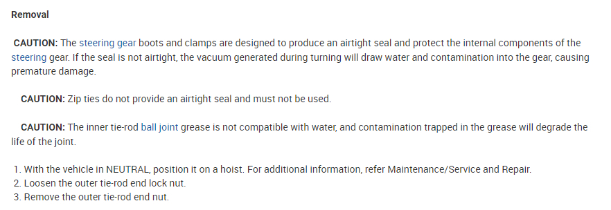

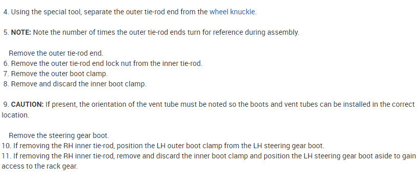

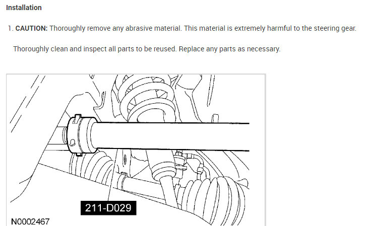

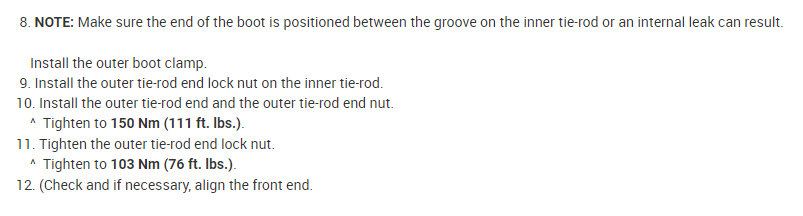

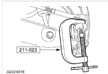

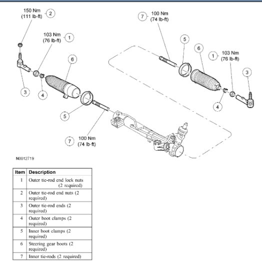

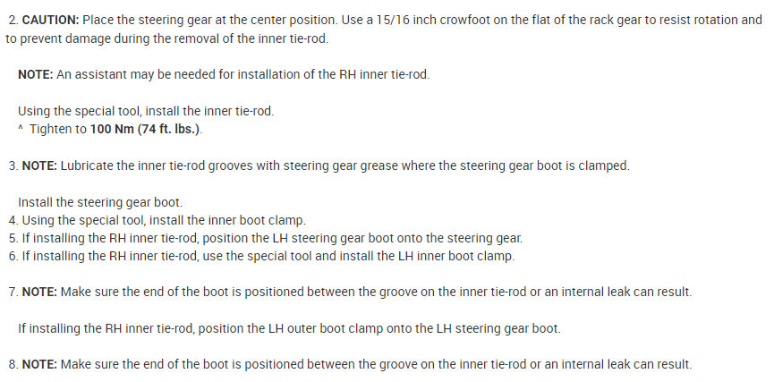

Here is the information you requested. Here is a tutorial showing how to replace tie rod ends:
https://www.2carpros.com/articles/tie-rod-end-replacement
I've attached picture steps below for the replacement of the outer tie rod ends on your Ford F150. After this repair you will need to have a front end end wheel alignment. Hope this helps and thanks for using 2CarPros.
