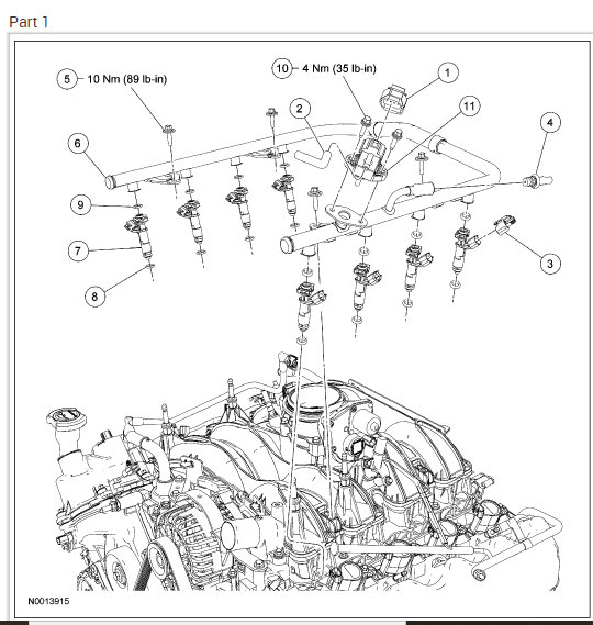

My truck is running terrible, it's misfiring and there is fuel dripping from the muffler and a seam in the exhaust pipe. What could be going on here?
Jul 15, 2009 at 6:17 PM
DANNY L
  • 5,648 POSTS
Hello, I'm Danny.

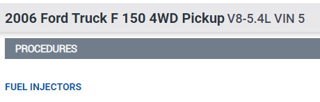

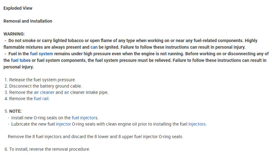

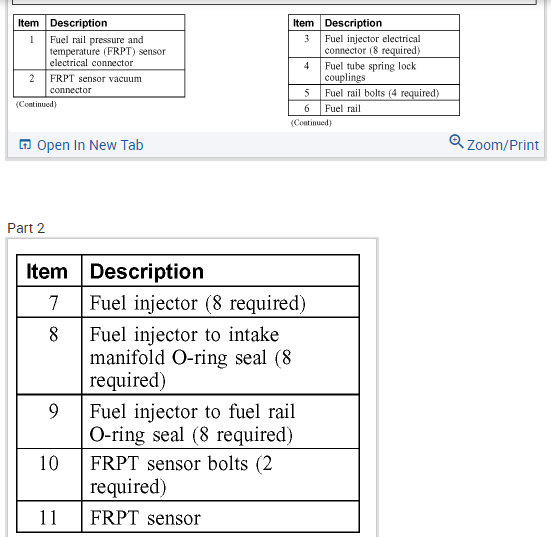

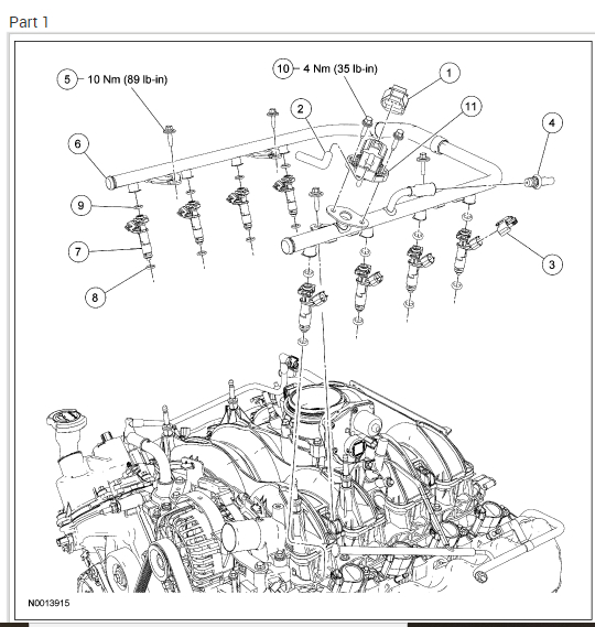

It's possible you have an injector or injectors that are stuck open causing raw fuel to be unburned and leaking into the exhaust system from your truck from running so rich. Here is a tutorial showing how to change fuel injectors:
https://www.2carpros.com/articles/how-to-replace-a-fuel-injector
I've attached picture steps below on how to remove and replace the fuel rail to gain access to the fuel injectors on your truck. Hope this helps and thanks for using 2CarPros.
