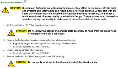

I need to replace the front wheel hub assemblies. Any advice on how much work is involved? Or is it easier to just replace the bearings?
