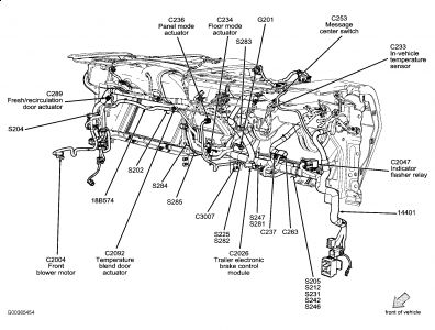

My flashers work but the turn signals don't. Which relay needs to be replaced?

Your indicator flasher relay, located behind left side of dash.
https://images.2carpros.com/forum/automotive_pictures/261618_Graphic_69.jpg
