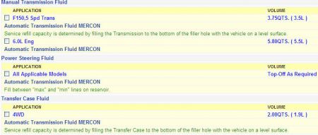

recently I had my oil changed and the tech. told me my trans. was down 1 qt. and that the fluid traveled into my front transfer case. Is rthis possible? If this is possible what kind of damage could occur to my trans. and how hard of a job is it to change the front axle seal?

IT's the same fluid.
https://images.2carpros.com/forum/automotive_pictures/30961_merc_2.jpg
I'm not following the logic by the oil changer... Changing the axle seal difficulty depends on several factors. IF things come apart easy or is a torch needed. IF you have a lift. If you have the tools. etc. Not A job I would do in the driveway myself. Damage can most certainly be done by running low on fluid.
