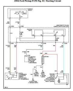

When I turn the key, I get one click and then nothing. It doesnot happen every time and once it finnaly starts, I can start it several times after without any problem. The truck sits for days at a time and then sometimes will repeat the issue and sometimes there is no sign of a problem.
I have had F-150 trucks forever and have replaced solenoids before but this one does not appear to have one. Is there a relay or other electronic device I should be looking for?
Please point me in the right direction as I start to look into this issue.

The function of the starting system is to crank the engine at a speed fast enough to permit the engine to start. Starting system consists of a starter motor, solenoid, battery, ignition switch, Digital Transmission Range (DTR) sensor, starter relay, and interconnecting cables and wires.
COMPONENT LOCATIONS
ComponentLocation
Central Junction Box....Behind Right Side Kick Panel
Digital Transmission Range Sensor....Left Side Of Transmission
Ignition Switch.....On Steering Column
Inertia Fuel Shutoff Switch....Behind Right Side Of Front Kick Panel
Powertrain Control Module.....Right Rear Of Engine Compartment
Starter Relay.....In Central Junction Box
https://www.2carpros.com/forum/automotive_pictures/266999_start_4.jpg
