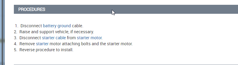

How many bolts do I need to take off to remove the starter?
Jul 16, 2009 at 3:07 PM
BLUELIGHTNIN6
  • 16,542 POSTS
Here is a guide to help you step by step with instructions in the diagrams below to show you how on your car. https://www.2carpros.com/articles/how-to-replace-a-starter-motor Check out the diagrams (Below). Please let us know if you need anything else to get the problem fixed.
https://images.2carpros.com/forum/automotive_pictures/261618_Noname_689.jpg

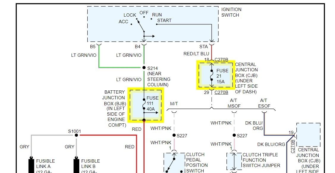

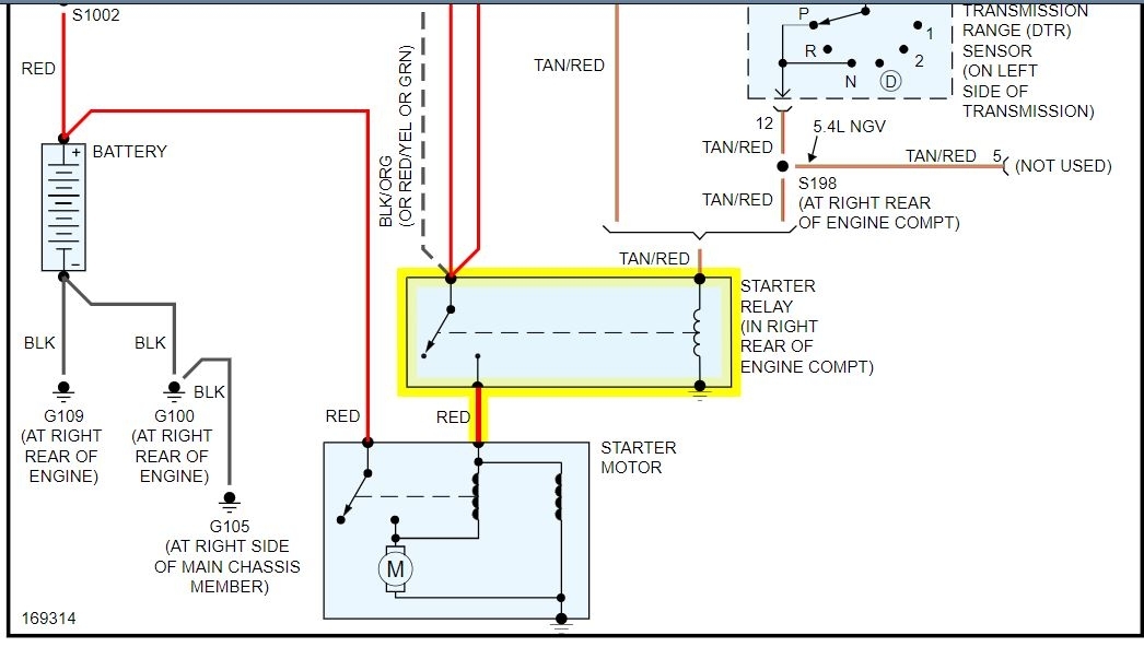

Good afternoon,
The click, is it coming from the starter motor?
Try tapping it with a hammer and see if it starts.
I attached a wiring diagram for you. Do you have a test light for testing?

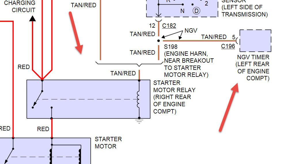

HMAC300
  • 48,601 POSTS
check for a sticky starter relay

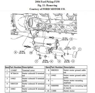

DAVE H
  • 13,384 POSTS
STARTER MOTOR Removal & Installation Disconnect negative battery cable. Raise and support vehicle. Remove starter solenoid terminal cover. Disconnect starter solenoid wire connections. On 4.2L engines, remove starter motor mounting nut and ground cable. On all engines, remove starter motor mounting bolts. Remove starter motor. To install, reverse removal procedure. Ensure negative battery cable is installed in proper location. Tighten fasteners to specification.
https://images.2carpros.com/forum/automotive_pictures/266999_starter_3.jpg

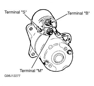

Yes, it sounds like you are having an issue with the starter solenoid on the starter motor. Here are a few tutorials for you to view about starter function and replacement:
https://www.2carpros.com/articles/how-a-starter-and-solenoid-works
I've attached picture steps below for the replacement of your starter motor on your truck below. Hope this helps and thanks for using 2CarPros.

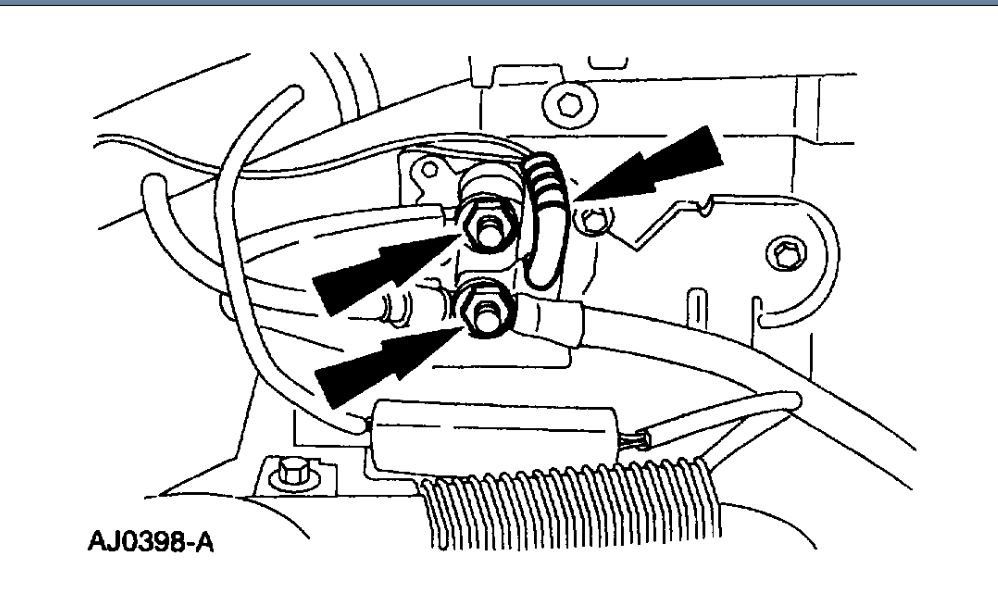

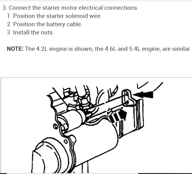

  • 110,244 POSTS

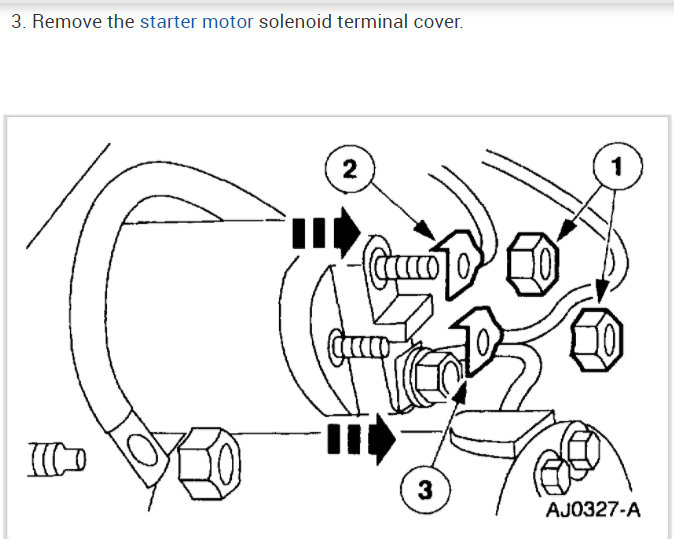

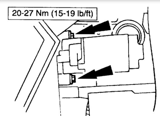

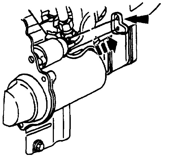

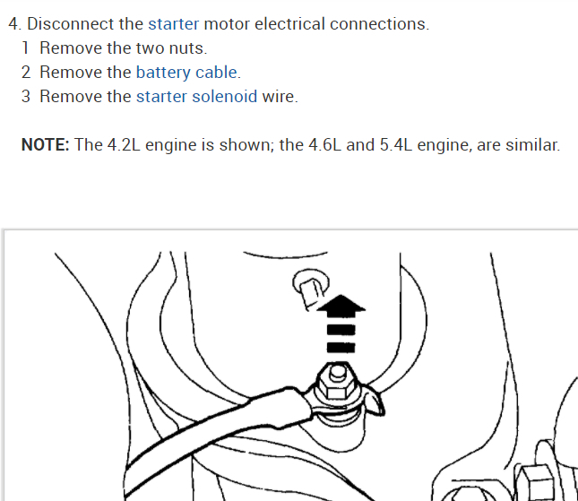

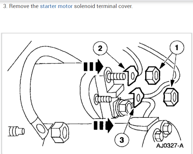

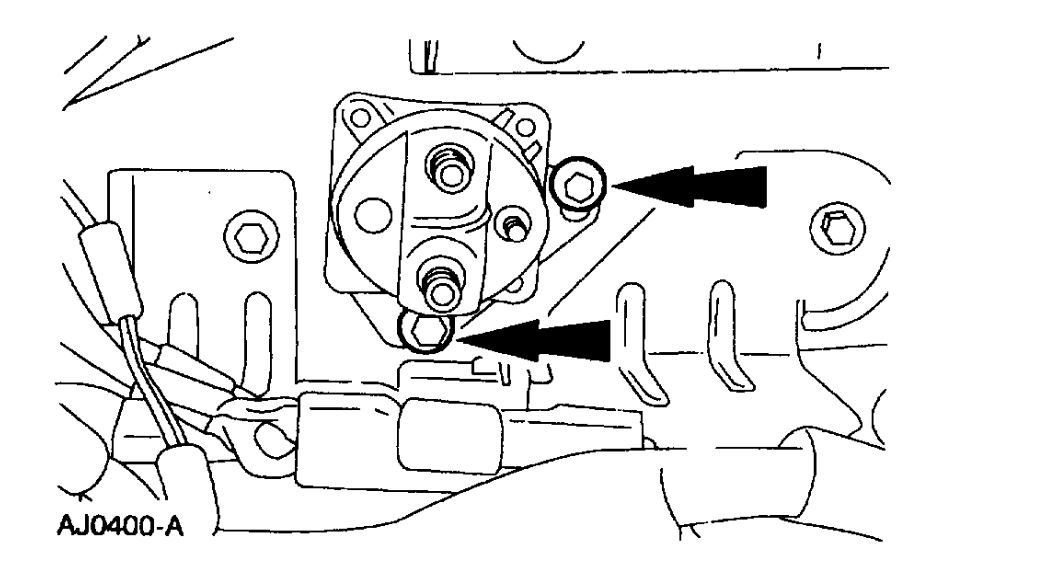

Truly, it sounds like a bad starter. What I need you to do is follow this link. It shows how to determine if the starter is bad.
As far as the wire that you mentioned, I have no idea which wire it is. If you could upload a picture, it would be helpful.
If you determine the starter is bad, here is a link that shows how one is replaced:

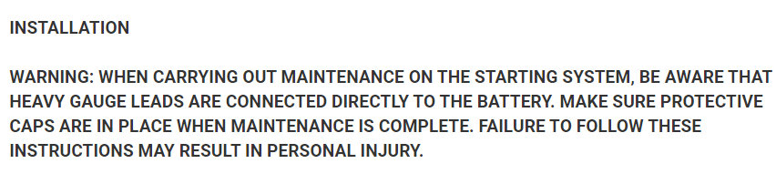

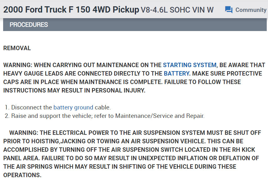

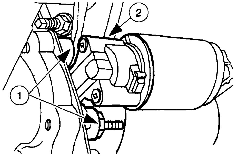

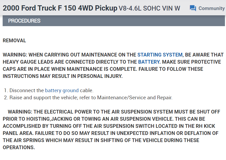

Here are directions specific to your vehicle. The attached pictures correlate with these directions.
REMOVAL AND INSTALLATION
REMOVAL
Warning: when performing maintenance on the starting system be aware that heavy gauge leads are connected directly to the battery. Make sure protective caps are in place when maintenance is complete.

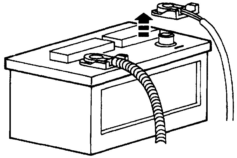

Picture 1
1. Disconnect the battery ground cable.
2. Raise and support the vehicle.
Warning: the electrical power to the air suspension system must be shut off prior to hoisting, jacking or towing an air suspension vehicle. This can be accomplished by turning off the air suspension switch located in the rh kick panel area. Failure to do so may result in unexpected inflation or deflation of the air springs which may result in shifting of the vehicle during these operations.

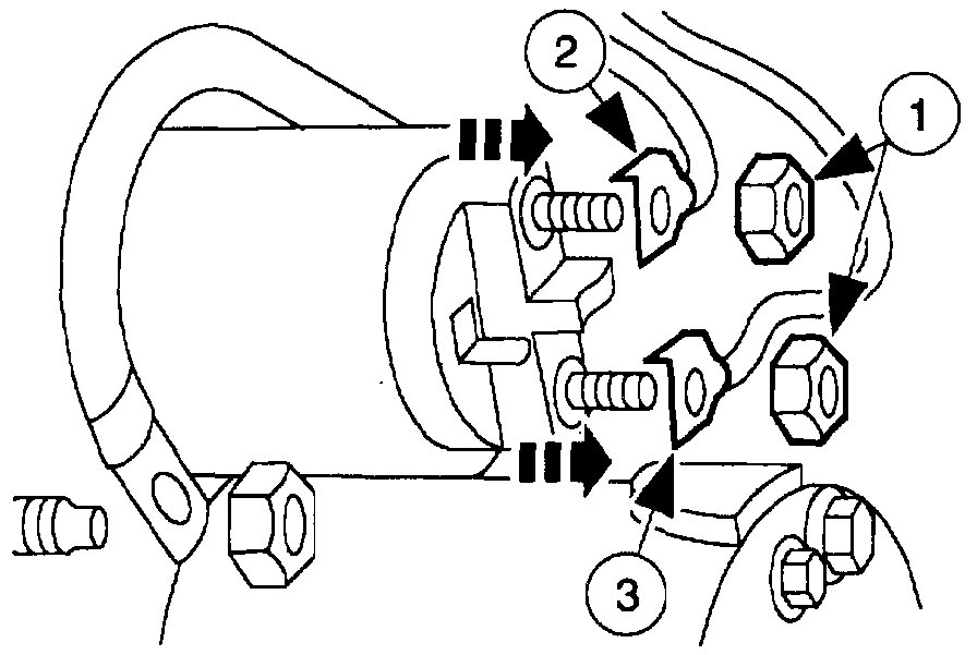

Picture 2

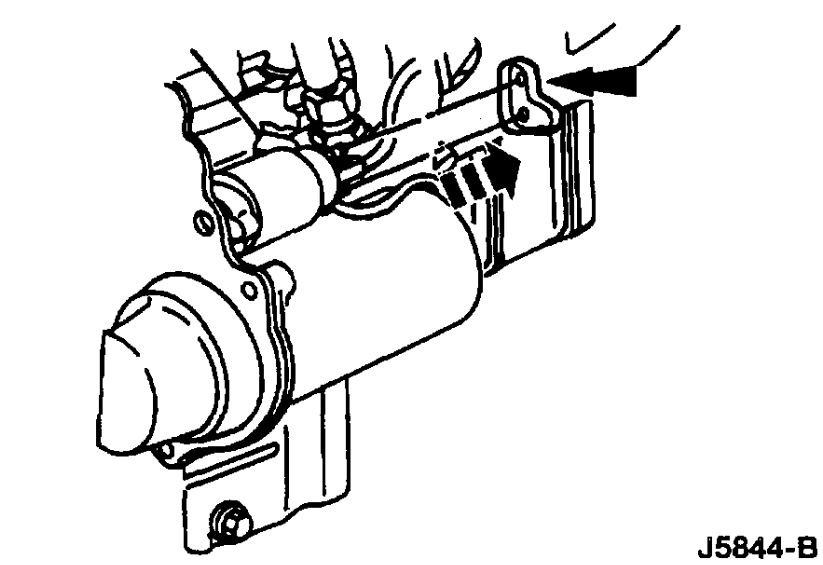

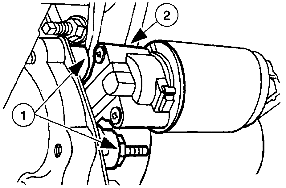

3. Remove the starter motor solenoid terminal cover
The 4.6L Engine Is Shown; The 4.2L Engine Is Similar

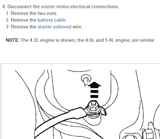

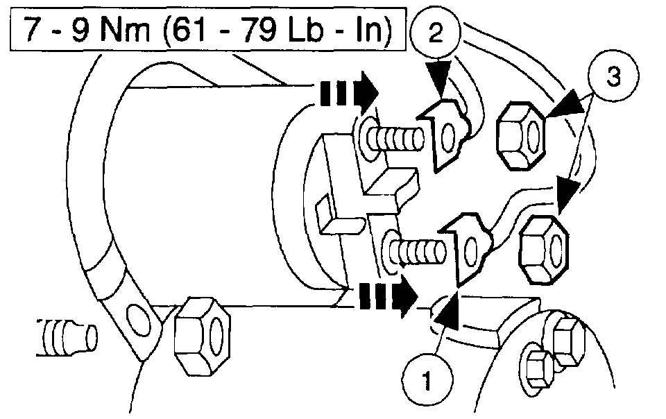

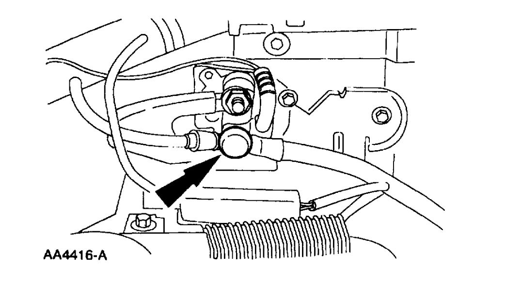

Picture 3

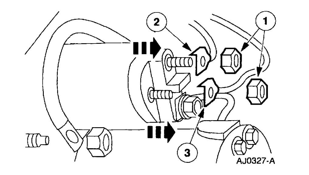

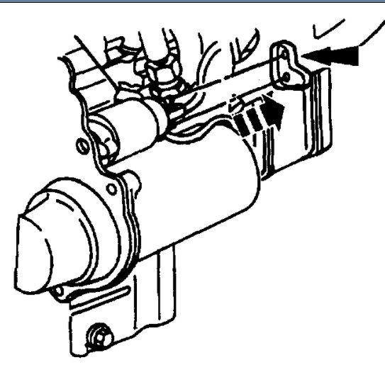

4. Disconnect the starter motor electrical connections.
1 Remove the nuts.
2 Remove the battery cable.
3 Remove the starter solenoid wire.

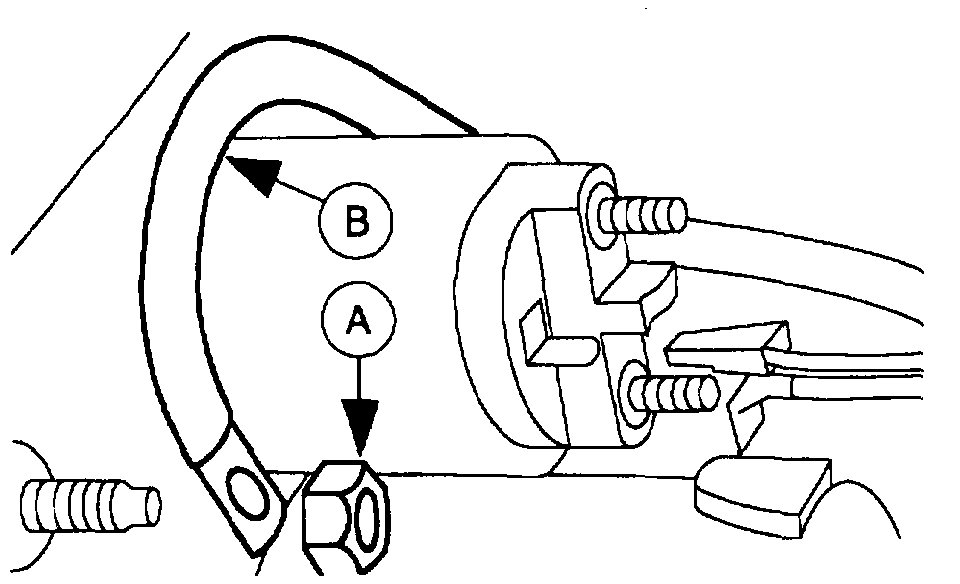

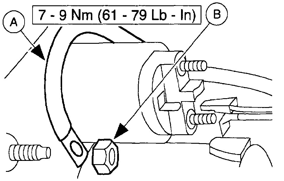

Picture 4

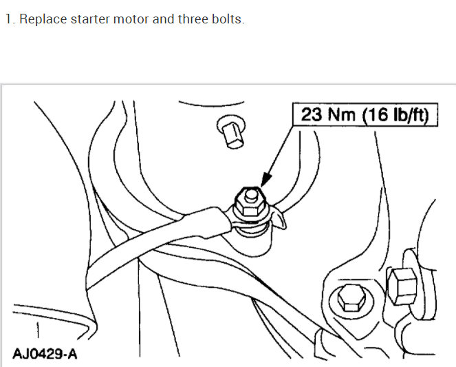

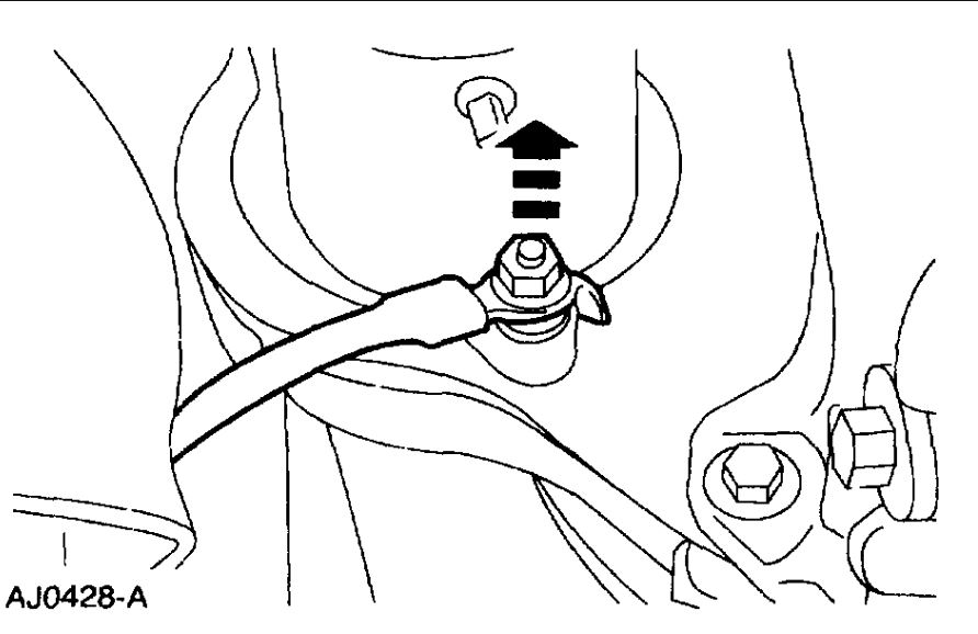

5. Remove the (A) starter motor ground cable nut and the (B) starter motor ground cable.
The 4.2L Engine Is Shown; The 4.6L Engine Is Similar

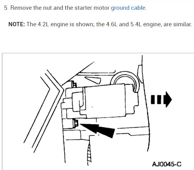

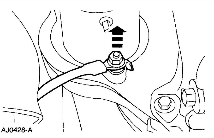

Pic 5

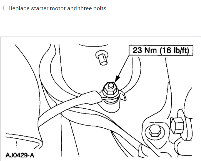

6. Remove the starter.
1 Remove the two bolts.
2 Remove the starter.

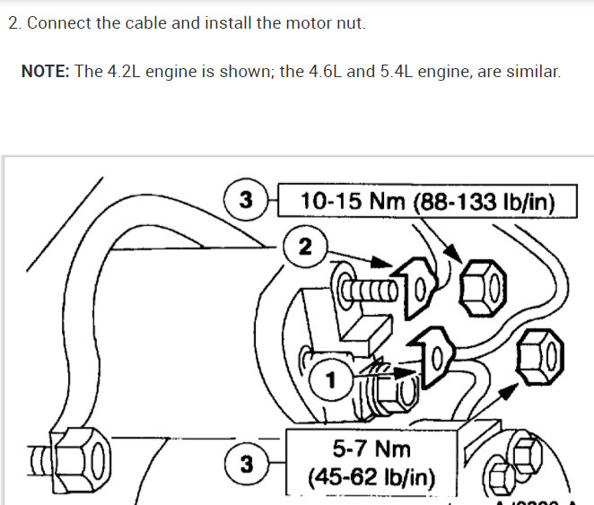

INSTALLATION

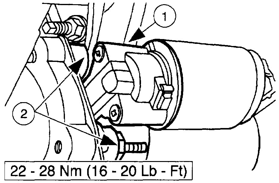

Picture 6
1. Install the starter motor.
1 Position the starter motor.
2 Install the two bolts.

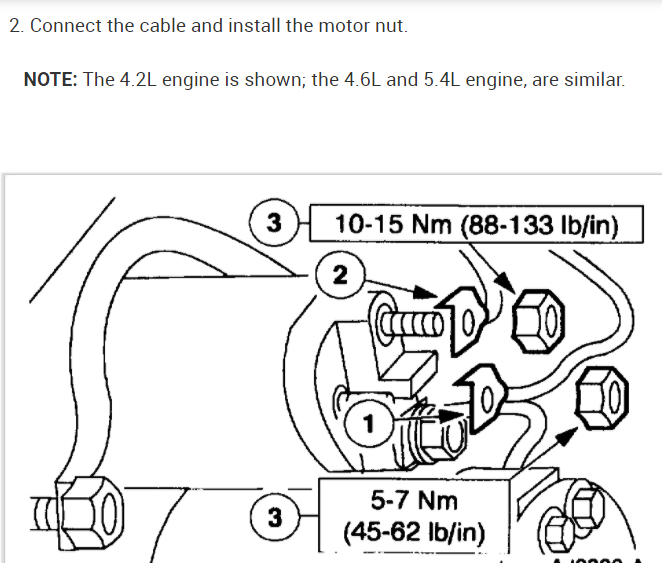

Picture 7
2. Connect the (A) starter motor ground cable and install the (B) starter motor ground cable nut.
Picture 8
3. Connect the starter motor electrical connections.
1 Position the starter solenoid wire.
2 Position the battery cable.
3 Install the two nuts.

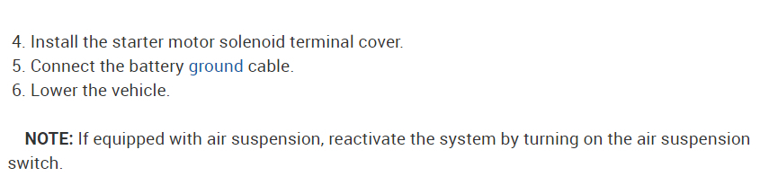

Picture 9

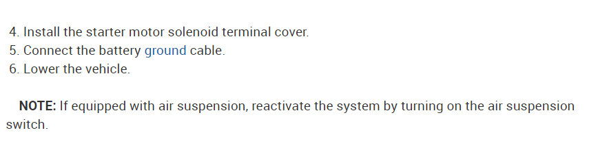

4. Install the starter motor solenoid terminal cover.
5. Lower the vehicle.
NOTE: If equipped with air suspension, reactivate the system by turning on the air suspension switch.
6. Connect the battery ground cable.
NOTE: When the battery is disconnected and reconnected, some abnormal drive symptoms may occur while the vehicle relearns its adaptive strategy. The vehicle may need to be driven 16 km (10 miles) or more to relearn the strategy.

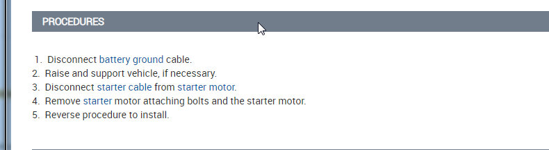

How to replace a starter ?
Jan 20, 2021 at 4:49 AM (Merged)
JDL
  • 16,098 POSTS
Disconnect battery ground cable
Safely raise and support the vehicle
Remove attaching bolts and starter motor shield
Caution: when disconnecting hard shell connector at starter motor solenoid s terminal, grasp the plastic shell and pull off. Do not pull on the wire. Be careful to pull straight off to prevent damage to connector and s terminal. If any part of connection is damaged, replace the damaged components.
Disconnect battery cable and push-on connector from starter solenoid.
Remove attaching bolts and starter motor.
