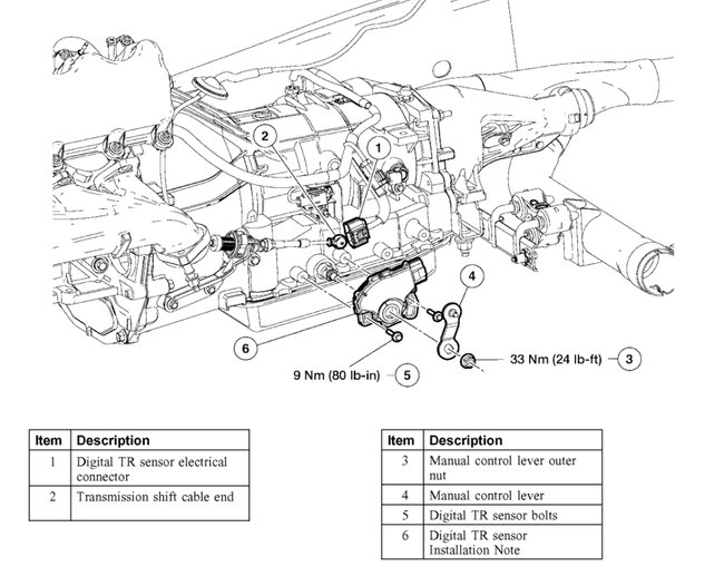

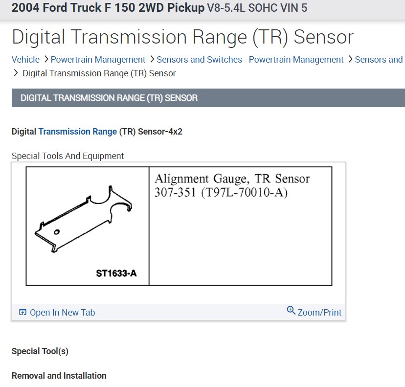

what is a neutral switch and how do I replace it?
Jul 11, 2009 at 10:46 AM
  • 75,992 POSTS

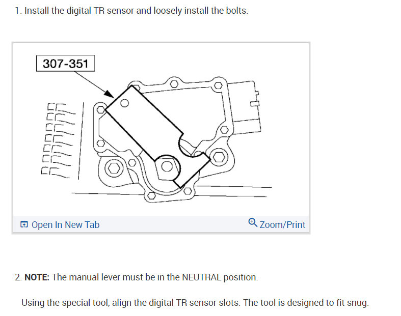

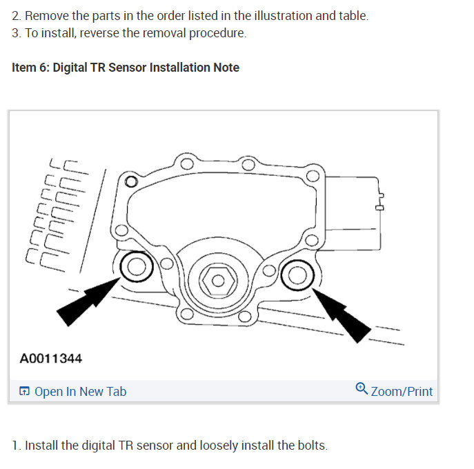

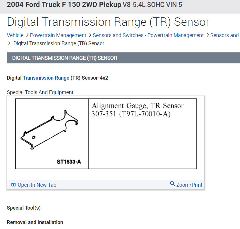

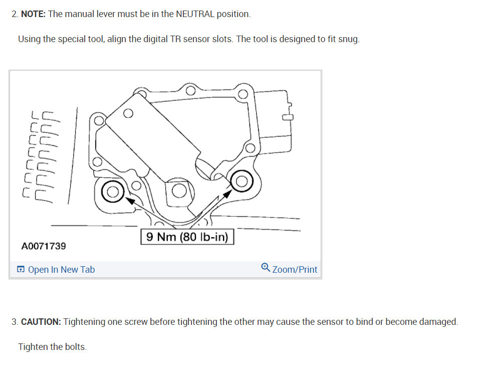

The NSS is to prevent starting the engine in any gear other than Park and Neutral position and its called digital transmission range sensor located on left side of transmission. Check out the diagrams (Below). Please let us know if you need anything else to get the problem fixed.
