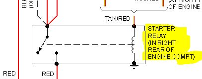

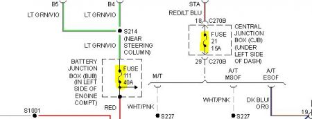

my truck won't start with the key. I have power to the solenoid but the wire that tells the solenoid to work doesn't. Is the problem the neutral safety switch on the transmission?
Jun 20, 2010 at 12:00 AM
MHPAUTOS
  • 31,937 POSTS
Hi there, Check starter relay and the two fuses indicated first, if ok, look at the isolator switch then.
