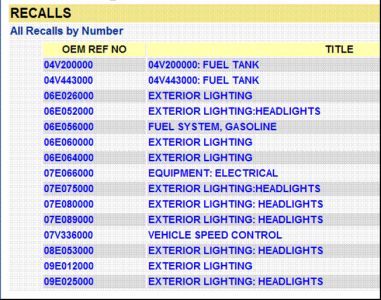

Hello - Also, it looks like you may have some recalls on your vehicle. The dealer may fix these for free. Please contact the dealer service department, give them the VIN number of your car and have them check on these to see if they apply to you.

There is no recall on it, however the door is known to break. From Ford you get a whole door Assy and is kid of difficult to remove

I saw there was no recall on the door itself…..these were all of the recalls that we showed for your vehicle if you wanted to check with the dealer to see if they applied to you and if any did they may fix them for free…
