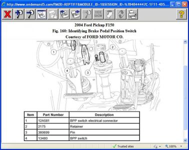

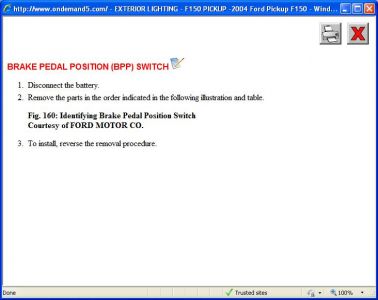

When I push on the brake pedal, the brake lights don't come on until I push a little harder. Once a reach a complete stop, I have to keep the brake pedal depressed harder than I think is necessary for the lights to stay on. What adjustment can I make to make the brake lights come on before I push the pedal harder? Thanks.

Frist of all thank you so much for your donation.It doesnt show a adjustment for the switch even when replacing it.So it looks like you have a problem with the switch itself.I posted the replacement procedure and the diagram of the parts you have to take off to replace the switch that the instructions mention.Let me know how it goes.
