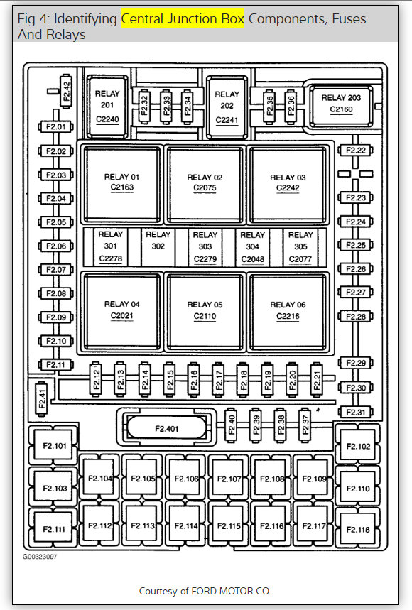

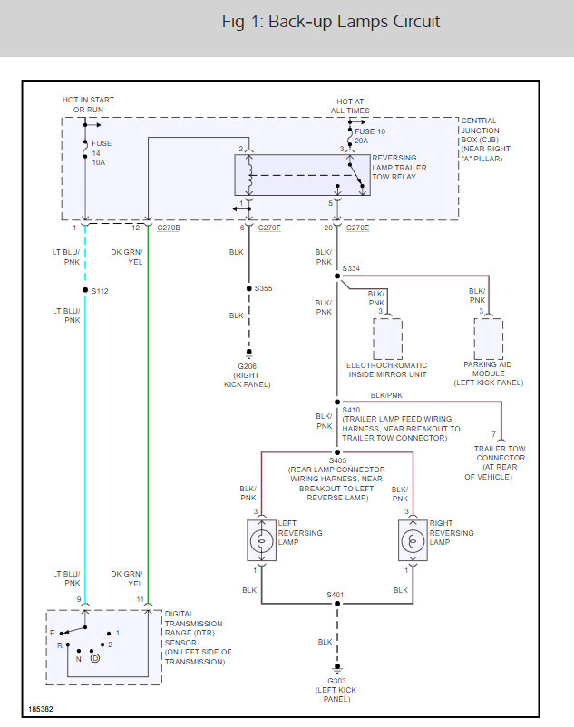

I have no reverse lights ,i have checked and changed the bulbs before having it checked by a friend he said there is no power to the bulbs.any answers?
Feb 11, 2010 at 6:21 AM
JDL
  • 16,098 POSTS

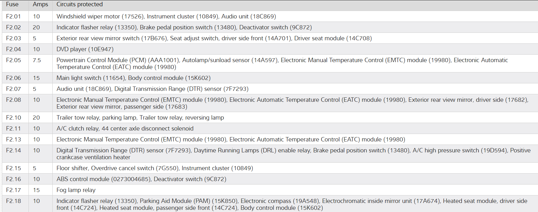

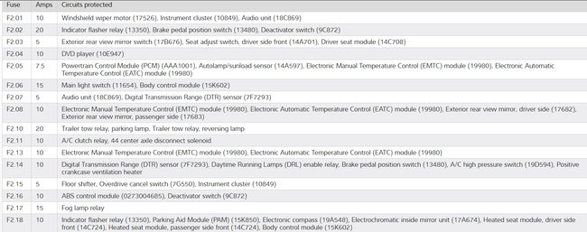

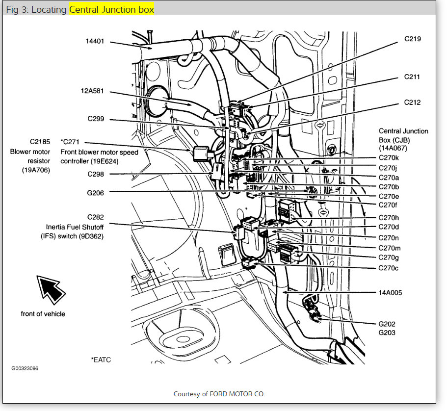

Check the reverse light relay, here is the location and the reverse lights wiring diagrams so you can see how it works.
Check the circuits at the transmission range sensor. For the back-up lights. Voltage to the sensor, lite blue wire with pink tracer. In reverse, black wire with pink tracer carries voltage to back-up lamps. There is also a ground for the back-up lamps, you may need to check that also.
Check out the diagrams (Below). Please let us know what you find. We are interested to see what it is.
Feb 11, 2010 at 7:54 AM
BROWNN

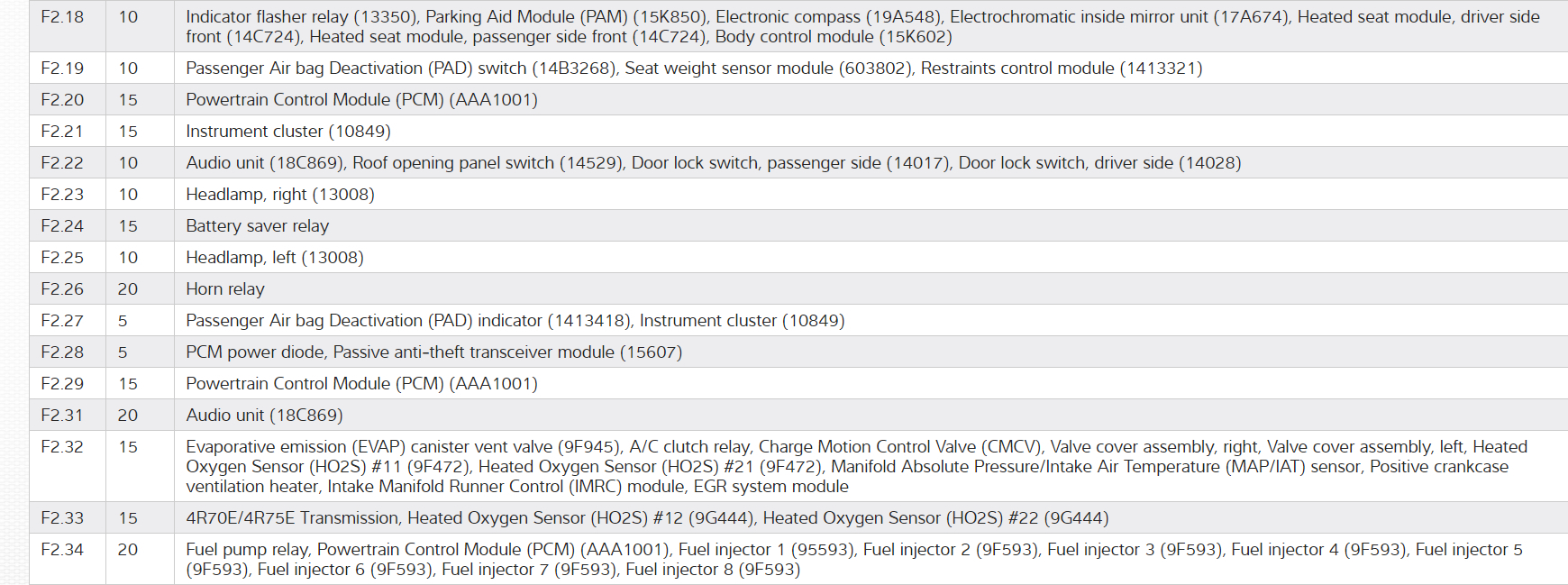

It was the #14 fuse on my truck thanks for the post I love this site.
