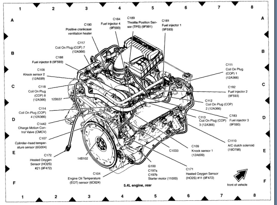

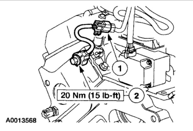

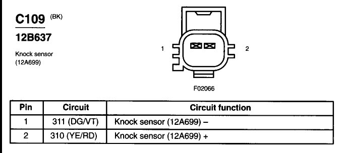

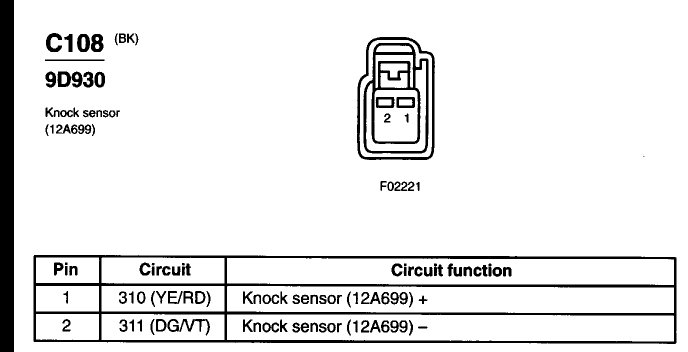

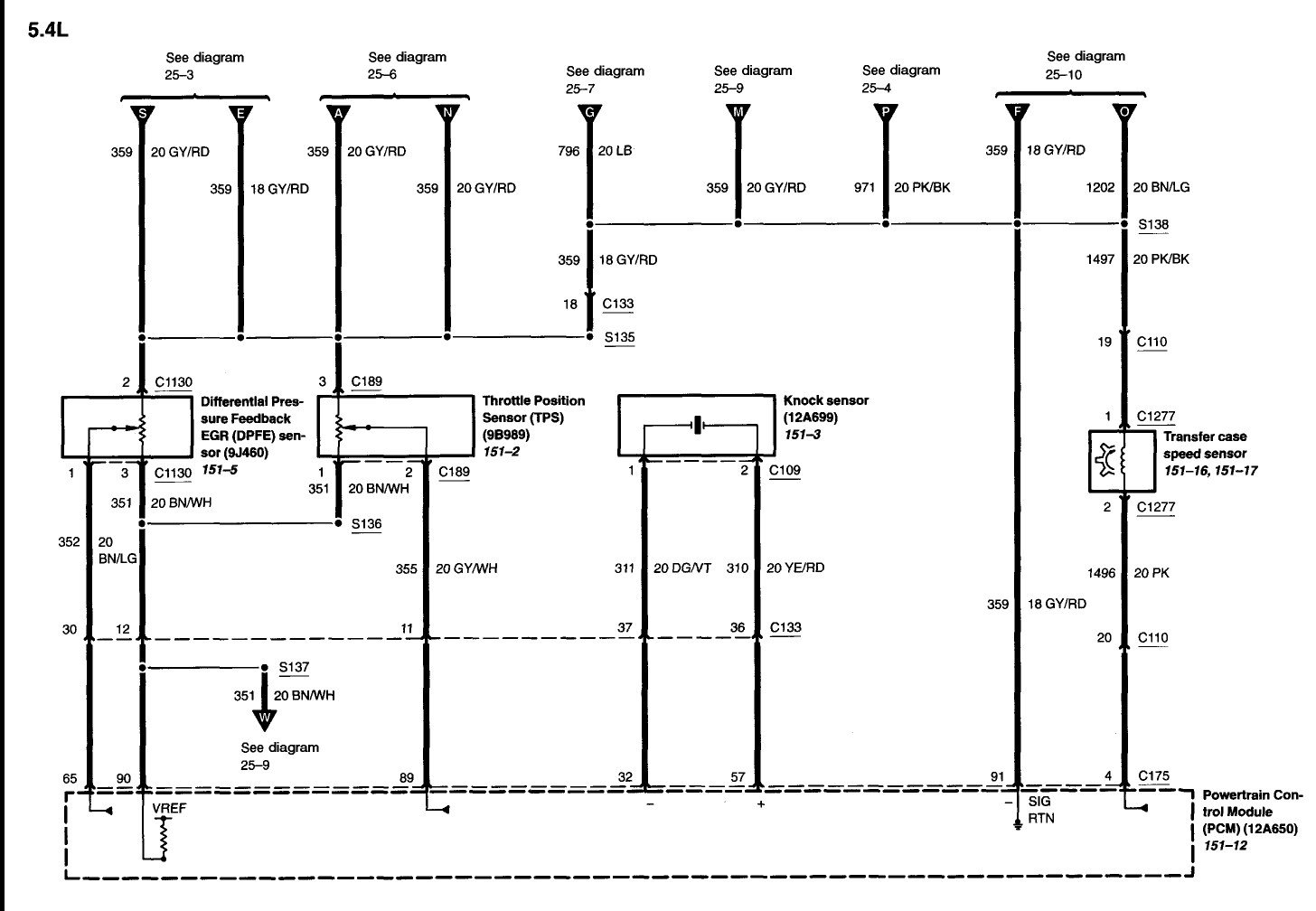

Check engine light on, computer show knock sensor code. If the 5.4 engine has 2 of them??
Sep 25, 2010 at 3:13 PM
That is correct. You have one for each bank. Your code should dictate which bank the code is for which will tell us which sensor the issue is with. I am attaching the info on these sensors for your review. Let us know what the actual code is and we can get more info if needed. Thanks

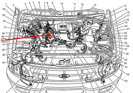

where is the knock sensor bank 1 located?
Dec 7, 2020 at 4:39 PM (Merged)
STEVE W.

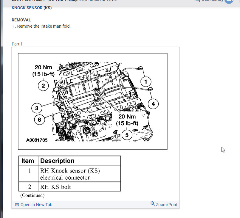

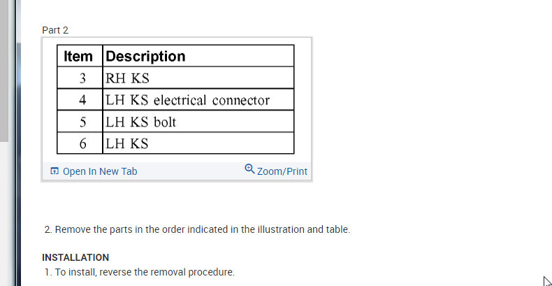

  • 15,200 POSTS
The knock sensor is under the intake manifold. You remove the intake and unscrew the sensor. There is a pinpoint test you can do.
DG1- CHECK KS SENSOR RESISTANCE
Note: Refer to the PCM connector pin numbers in the beginning of this pinpoint test.
Disconnect KS, measure resistance through the KS harness connector pins
Is resistance between 4.39 and 5.35 megaohms?
Yes = GO to DG2
No = For resistance less than 4.39 megohm: GO to DG3
DG2 - CHECK FOR OPEN OF KS CIRCUIT BETWEEN KS HARNESS CONNECTOR AND PCM HARNESS CONNECTOR
Disconnect PCM.
Measure resistance of the KS+ circuit between the PCM harness connector pin and the KS harness connector.
Measure resistance of KS- circuit between the PCM harness connector pin and the KS harness connector.
Is each resistance less than 5.0 ohms?
Yes = REPLACE KS.
No = REPAIR open circuit.
DG3 - CHECK KS CIRCUIT FOR SHORT TO GROUND IN HARNESS
Measure resistance between the KS- circuit at the PCM harness connector and chassis GND.
Measure resistance between the KS+ circuit at the PCM harness connector and chassis GND.
Is each resistance greater than 10,000 ohms?
Yes = GO to DG4
No = SERVICE short circuit.
DG4 - CHECK KS CIRCUITS FOR SHORT TO POWER IN HARNESS
Disconnect PCM.
Turn Key on.
Measure voltage between the KS+ circuit at the PCM harness connector and battery negative post.
Is the voltage less than 0.5 volt?
Yes = REPLACE PCM See: Programming and Relearning
DG5 - CHECK KS CIRCUIT FOR INTERMITTENT FAULT
Key off.
Measure the resistance for KS+ between the PCM and KS harness connectors, while viewing the ohm meter, grasp the vehicle harness as close to the knock sensor(s) as possible. Shake and bend a small section of the harness from the KS sensor to the PCM.
Measure the resistance for KS- between the PCM and KS harness connectors, while viewing the ohm meter, grasp the vehicle harness as close to the knock sensor(s) as possible. Shake and bend a small section of the harness from the KS sensor to the PCM.
Tap the PCM and KS connectors if possible.
Are the resistance readings changing?
Yes = ISOLATE fault and SERVICE as required.
No = GO to DG6
DG6 - CHECK INTERNAL PCM RESISTANCE
Disconnect knock sensor (KS) harness connector.
Measure resistance between KS+ and KS- pins through the harness connector.
Is resistance greater than 10,000 ohms?
Yes = REPLACE KS. If concern is still present, REPLACE PCM See: Programming and Relearning).
No = REPLACE PCM See: Programming and Relearning.

Engine Mechanical problem 6 cyl Two Wheel Drive Manual 237214 miles
I would like to know where the knock sensor is located on my 2001 F-150. Can you help me out with this puzzle? I love this site
Dec 9, 2020 at 8:54 AM (Merged)
  • 54,840 POSTS
The knock sensor for the v6 engine is at the rear of the engine block while the v8 engine has the sensor under the intake manifold. Here are some diagrams so you can see what I am talking about. (below)

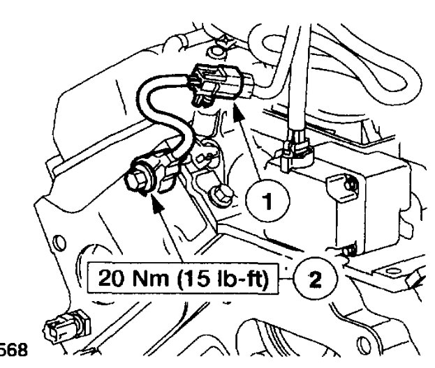

I have heard the knock sensor will be located on the right front of the engine for the 2001 F150 4.2L V6 ? is this correct and could anyone post a diagram indicating its exact position? thanks

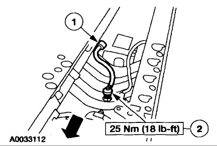

DANNY L
  • 5,648 POSTS
Hello, I'm Danny.
Yes, you are correct. I've attached a picture below showing its location.Hope this helps and thanks for using 2CarPros.

BIGFOOT26

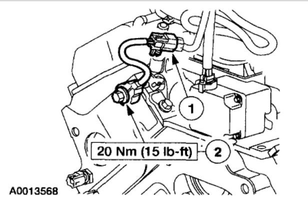

I have tried an tried to find and watch videos for this repair. And or pictures but cannot get a direct answer for the location for the sensor. All I have found was by the starter I have looked an cannot find this. Any information an pictures would greatly help.

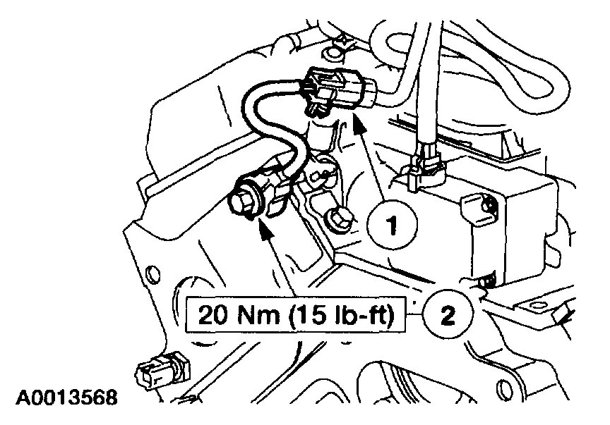

  • 110,194 POSTS
Hi and welcome to 2carpros.com
It will be mounted to the cylinder head, either the front or rear. (if I recall it's the driver's side rear head) I attached a picture of its location to help you find it.
Let me know if this helps of if you have other questions.

  • 110,194 POSTS
Hi:
You are very welcome. Here are directions for replacement. The attached pic correlates with the directions.
_________________________
2000 Ford Truck F 150 2WD Pickup V6-4.2L VIN 2
Procedures
Vehicle Powertrain Management Sensors and Switches - Powertrain Management Sensors and Switches - Computers and Control Systems Knock Sensor Service and Repair Procedures
PROCEDURES
REMOVAL
pic 1
1. Remove the Knock Sensor (KS).
1 Disconnect the electrical connector.
2 Remove the bolt and the KS.
INSTALLATION
1. To install, reverse the removal procedure.

BLUELIGHTNIN6
  • 16,542 POSTS
The knock sensor will be located on the right front of the engine for the 4.2L and on the right side of the engine for the 4.6L and 5.4L engines. I can post diagram if you specify your correct engine size.

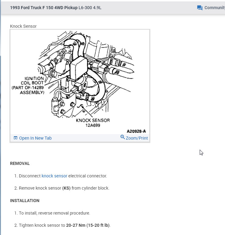

JGANAWAY
  • 42 POSTS

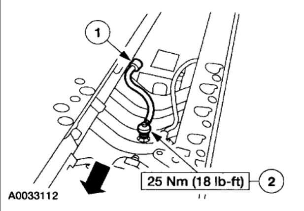

Where is the knock sensor located on a 4.9?
I attached the process from the manual to replace this sensor. Let me know if you need more info and we can dig something up. Check out the diagrams (Below). Please let us know what happens. Thanks
