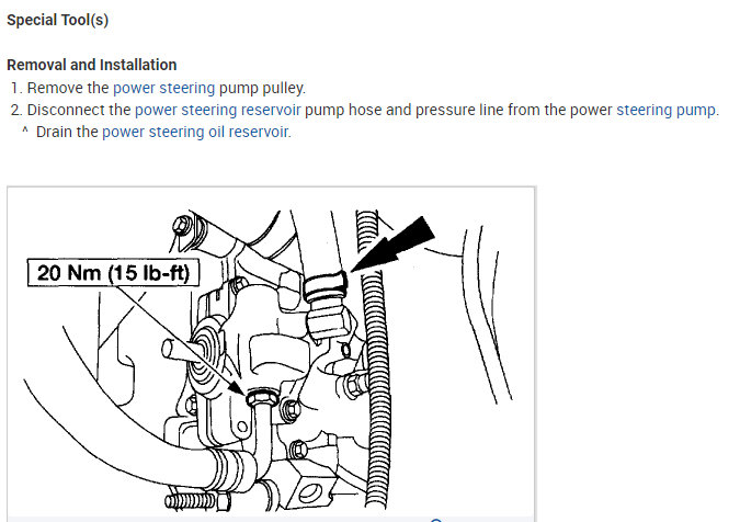

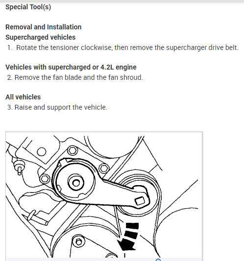

A few weeks ago I noticed my power steering fluid was low. I refilled it and then it became low again i checked under the truck for leaks i found a slow leak coming from the pump.
Jan 19, 2009 at 10:55 AM
DANNY L
  • 5,648 POSTS
Hello, I'm Danny.

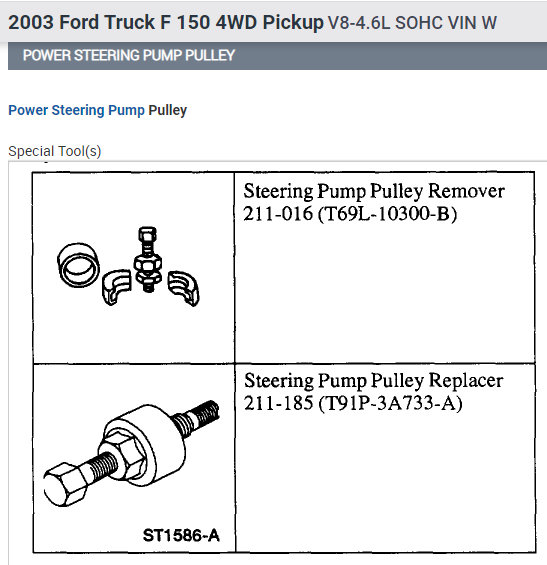

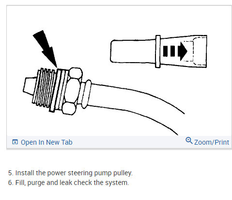

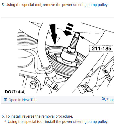

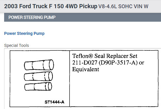

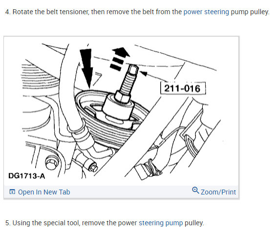

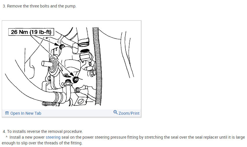

Here is the information you requested. Here are a few tutorials showing how to remove and replace a power steering pump and pulley:
https://www.2carpros.com/articles/how-to-replace-a-power-steering-pump
https://www.2carpros.com/articles/remove-reinstall-power-steering-pulley
I've attached picture replacement steps below on your truck for replacing the power steering pulley and how to remove and replace the pump. Hope this helps and thanks for using 2CarPros.
