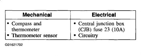

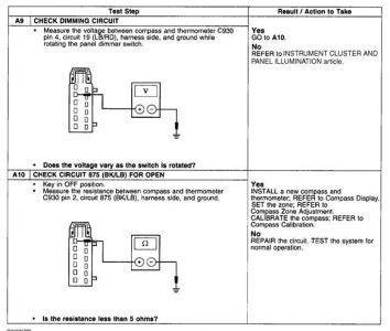

2003 Ford F150 Outside Temperature and Compass Direction
2003 FORD F-150
80,000 MILES • 6 CYL • 2WD • AUTOMATIC
BOBBYBOB123456
Outside Temperature And Compass Direction Are Not Working And No Power. Cannot Find Fuse. Any Suggestions?
